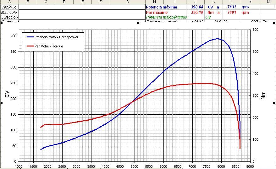

I had turbo and SC, if you want lower times in 1/4 mile runs, turbo is better than SC since it gives more power sooner.
At same psi turbo give more power.
it you want run road track and twisted roads I prefer SC, since it gives power more linear
below there is a cuver with SC, 6psi, and turbo,7 psi.
