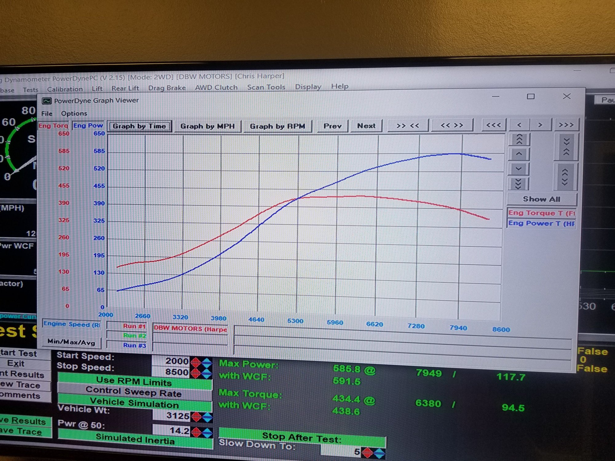

tbh, my experience with turbos in general is very limited. I was just going based off what precision told me and a little bit of what all the internet "experts" claimed. It came with a .035 restrictor and was told not to mess with it. Precision's claim was that it was 100% my drain that was the issue...except my drain is straight up and down and my crank is vented via 2 an -10. I still think there was an underlying problem with that turbo from the start. I don't see having too much oil pressure making bearings eat themselves and that turbo being junk in less than a year
Anyway, that comparison is kinda apples to oranges. The bw is a 257 that is maxed out at 100hp over what I was running the precision at and has a ton of tq off the line. The transient response of this turbo makes this car insanely good for driving around town and just normal driving. There is a guy with a white s2k with a J's body kit that tracks his car. He is running an F24 aswell but with a 3076r. His graph is almost identical to mine but he was able to extract a good bit more tq.
The precision was slow as hell to spool and was only pushed to 500hp, it felt like driving the car around stock tbh, until 4300ish when it came on like a freight train.
My end goal was to be in the mid-high 700s with a 3582r, but the spool is so damn good on this borg I dont know if I want to change it.
this was the borg. I dunno where my graph of the precision went.
this is the graph of the borg.

I forgot the guys name, but this is his graph with the F24 and a 3076r...its damn impressive as well.

Is that graph on a built engine or stock? Before I comment on the power curve
