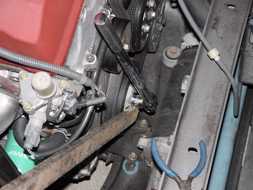

Crank pulleys on F20Cs are notoriously hard to get off. With the engine in the car you can't get to it with an impact gun and a short breaker bar has nowhere near the leverage required for the stubborn ones.
I made a crank pulley tool:
And used a 19mm socket on a breaker bar.
But that wasn't the whole story. I had to use a length of steel pipe about two foot long on the end of it and yank with all my strength and not inconsiderable weight to break it loose.
