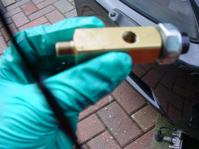

I think I'm missing this part from my Vortech kit.
Is it this?
7P125-125 1/8 NPT FEM x 1/8 BSPT 1
from the vortech manual?
Also, I believe I am missing the Vtec solenoid gasket -- hope they aren't a mint at the dealer?

No help on the oil sender adapter?
Anyone know specs on this so maybe I can buy something similar?

it is indeed 7P125-125, by looking at an S2000 vortech manual (pg11):
http://www.vortechsuperchargers.com/...s/4HS218im.pdf
the male side of the fitting (1/8 BSPT) goes into the block in place of the stock oil sensor for the dummy lamp; the opposite female bung is also 1/8 BSPT to accept the oil pressure sensor
the female port on the side of the fitting is 1/8 NPT as that is a more widely used pipe thread in the US; off the 1/8 NPT you use a elbow (90 degree) fitting which has a #4 flare on the opposite end for the oil line
hopefully you can just order the part from vortech; BSP fittings are hard to find.. i had to go through this when a similar fitting of mine broke
