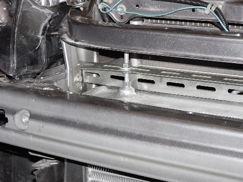

Custom rail bolted to stock bolt holes, threaded rod to hang IC. It also has a bracket at the bottom to stop it from swinging.
End result is a 300x600x76 IC securely mounted but retaining the grill slats (had to trim the points at each end) and no modification to faux air vents.
I've since added a water spray across one of the grill slats and cut out the faux ducts to make functional brake cooling ducts.
