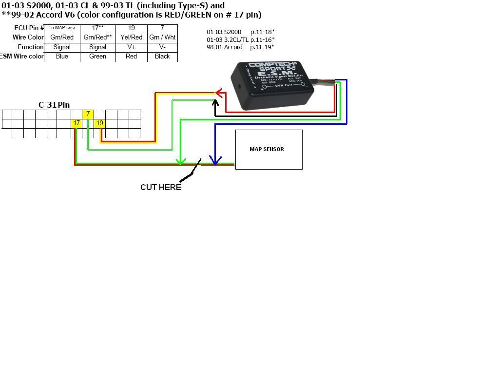

i went to the tune shop today mind u there arent any around here that tune hondas or work on them let alone a s2000 sc the tune shop i go to has tuned a few hondas with the emanage blue but there telling me they cant get the map sensor to let boost through they need to order another part so this may sound stupid i dont care though im just trying to figure out wut else i could need? he said the part blocks the map senser but i dont understand why he actually has to put something there when the comptech esm is wired in im so confused .....help

I'm sorry but are you using the emanage blue, ESM or both?
If you're using the ESM check all the wiring, make sure it looks like this. If the connections are crimped solder them.
If you're using the Emanage blue you don't need any other parts - get rid of the ESM, go in the BC menu and type in the voltage you want to clamp your map at - around 2.85-2.90 usually works.

thanks thats wut i needed to know im using just greddy blue
