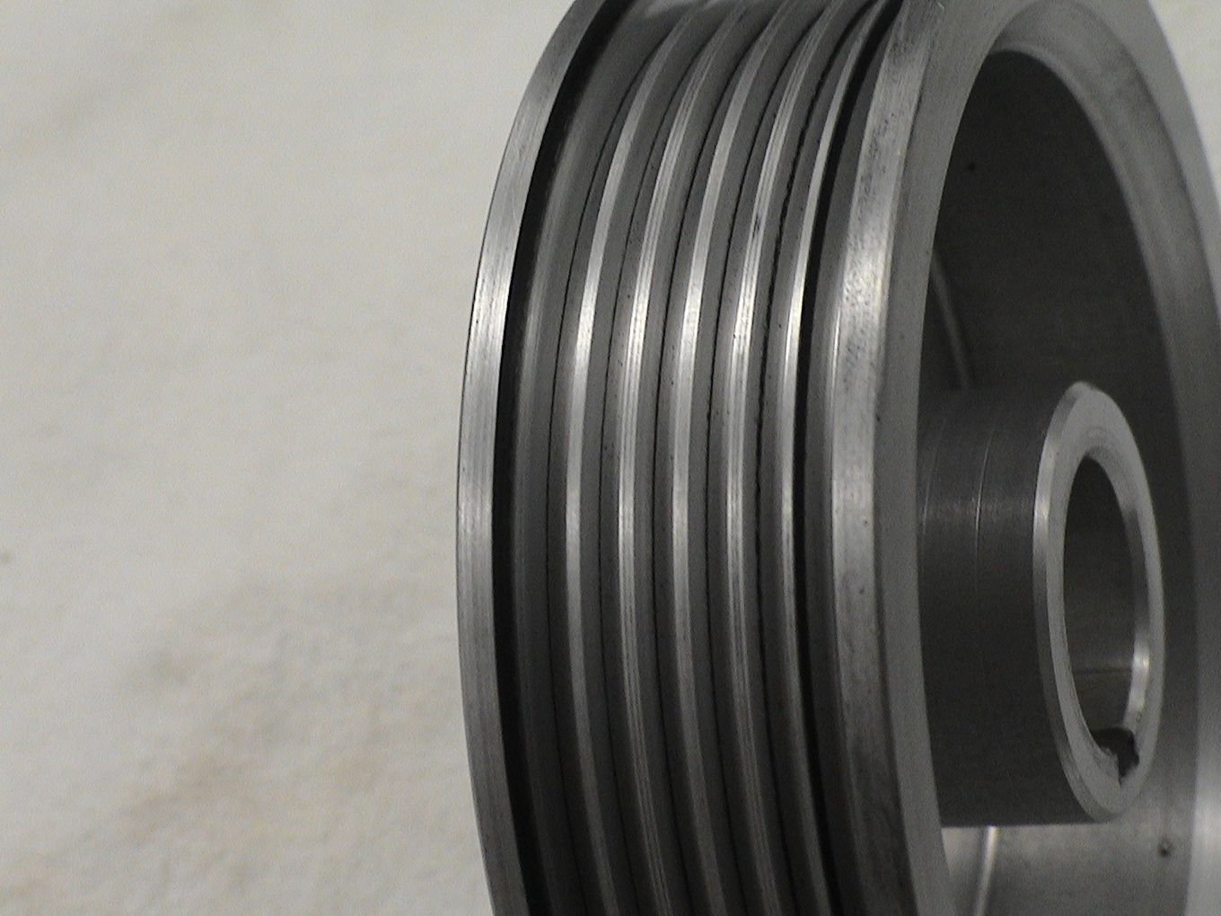

Originally Posted by Sideways,Sep 12 2008, 07:19 PM
The Reicard pulley has eliminated the belt slip.
The belt slip was obvious on this pulley. The belt has deposited a black glazed rubber layer on the sides of the ribs. This happened in about 300 miles.

what is the special thing on the reicard pulley that eliminates belt slip
thanks in advance

It's the cross grooves cut into the pulley.
They communicate with a hole that can be seen in this photo:
