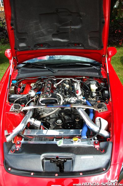

So i've done the basics:
Koyo radiator, mugen thermostat/switch, carbon cooling plate (front of radiator -> radiator), better hoses, oil cooler.
My car is turbo'd and running 1.6bar on a GT3076R. It's got about 500whp.
When I drive it for a few minutes between 200 - 285 km/h the engine temps begin to rise above recommended. Well oil temps is at 110C and water temp 100C. If I continue to drive like that the temps rise even more.
Speeds below 180km/h aren't a problem.
What can I do to keep the temps down and more air in the radiator?
My intercooler is up front ofcourse and causing alot of air to go through it instead of through the radiator. So I suppose cutting the bumper would be an idea.
Will Venting the hood make a difference?
What about under the car, making vents?
I've still got the AP1 bumper on tha car but have a Shine (ASM replica) ready to go.
