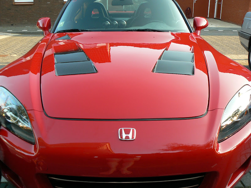

Update: I got a vented hood and all overheating problems are history.
I can pull from 200-285km/h all day long without the system overheating.

Thanks for the update. Interesting for the cooling issues you were having that venting the engine bay would greatly increase your cooling efficiency. Nice

very nice...what hood is that?

It's a Top Secret hood.
