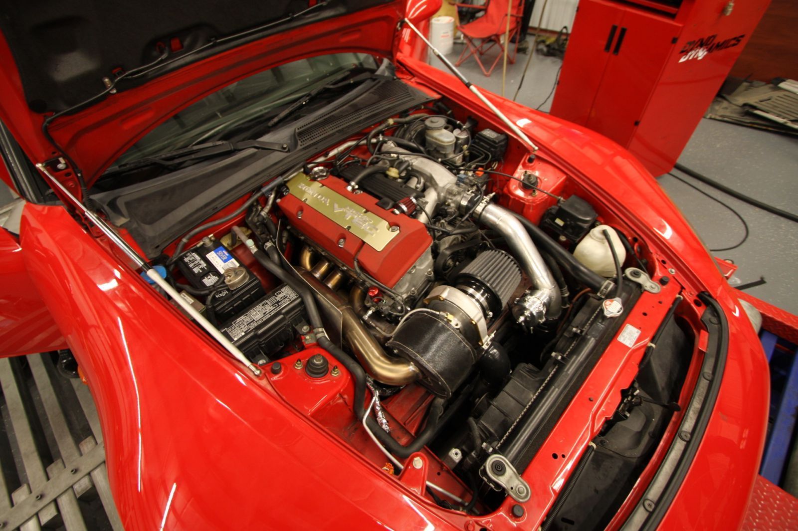

[QUOTE=boostedf22c,Oct 26 2009, 05:34 PM] Some of us can get up to 160 a lot faster than others too.

D*mnit Carey! I can't see that on my blackberry, its too small. Lol Can you explain where it is? Is it a cold air intake or pretty much like mine is. I just ordered my 6262 turbo and was going to leave the filter like my old turbo was. Do you think it'll be ok or should I run a pipe to somewhere?

And for comparisons sake...
Your filter is 6-8 inches away from your turbo, mine is directly connected. Your hood is also vented.
Hell now that I look at my engine bay, I don't really have a lot of options for an extended filter setup like you have...

Well ####! Never mind Carey. Lmao ithe pick popped up bigger and now I can see it. What filter do you recommend and where do I get it? I need it for the 4" inlet.

I agree, but with my setup I'm pulling in ambient air that's been heated by the directly connected turbo. I've actually got it setup slightly different than that I posted...I extended the filter with a rubber coupling towards the charge piping (maybe 3.5 inches). Dunno if its helping or not.

And dude, you've got a big ****ing filter. I'm mad jealous yo. Guess I don't measure up
