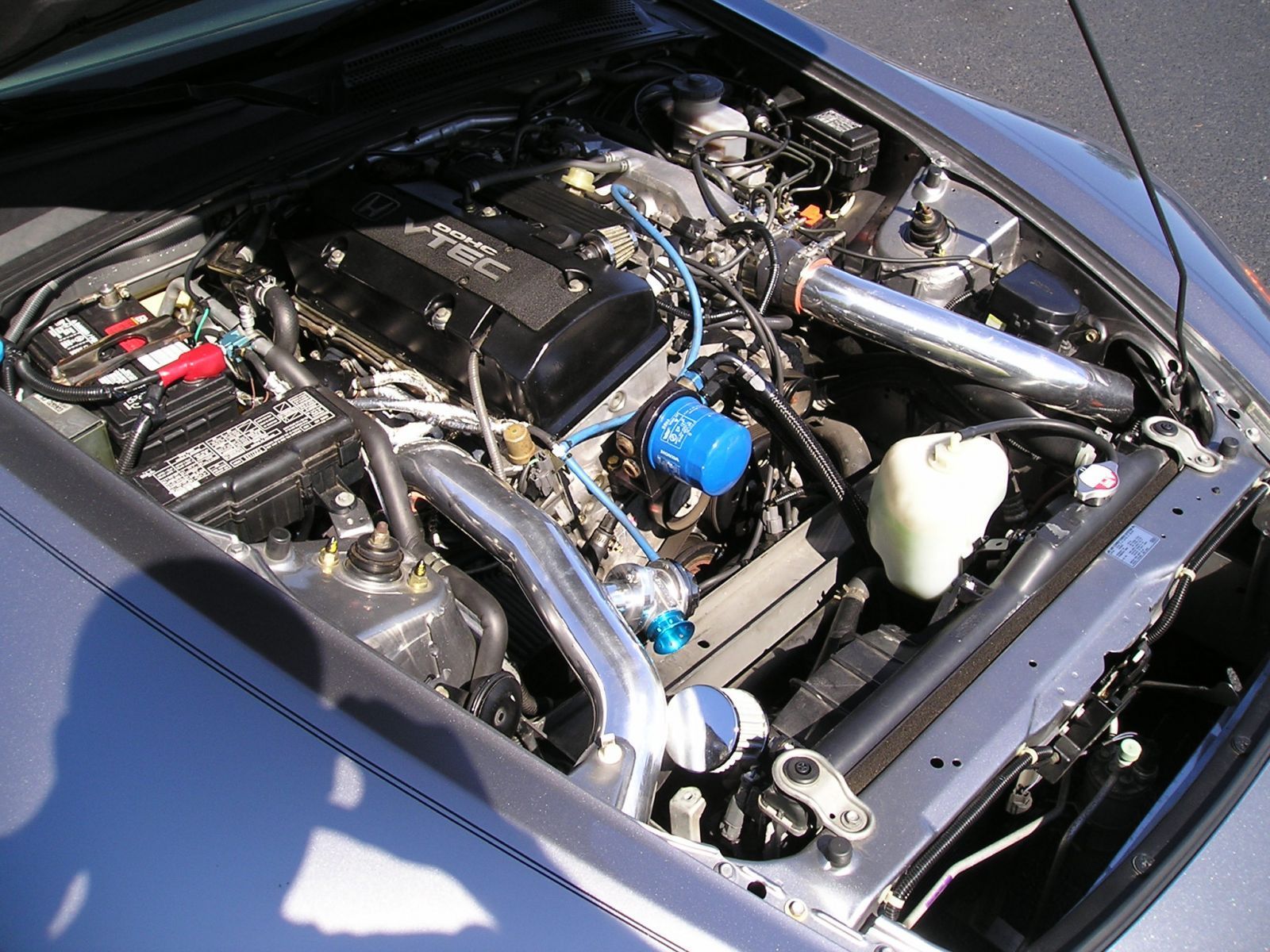

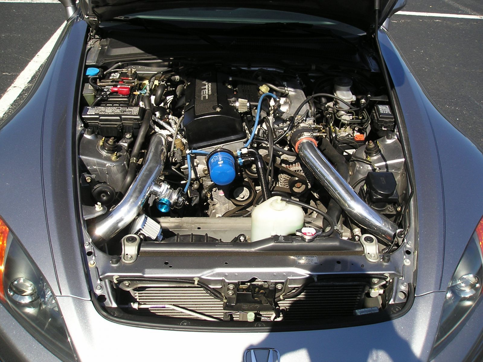

Here is a couple pics of my engine bay, I have taken the car back over to Ptuning to get a re-tune on the AEM. I also have some kind of rattle they are going to fix.
