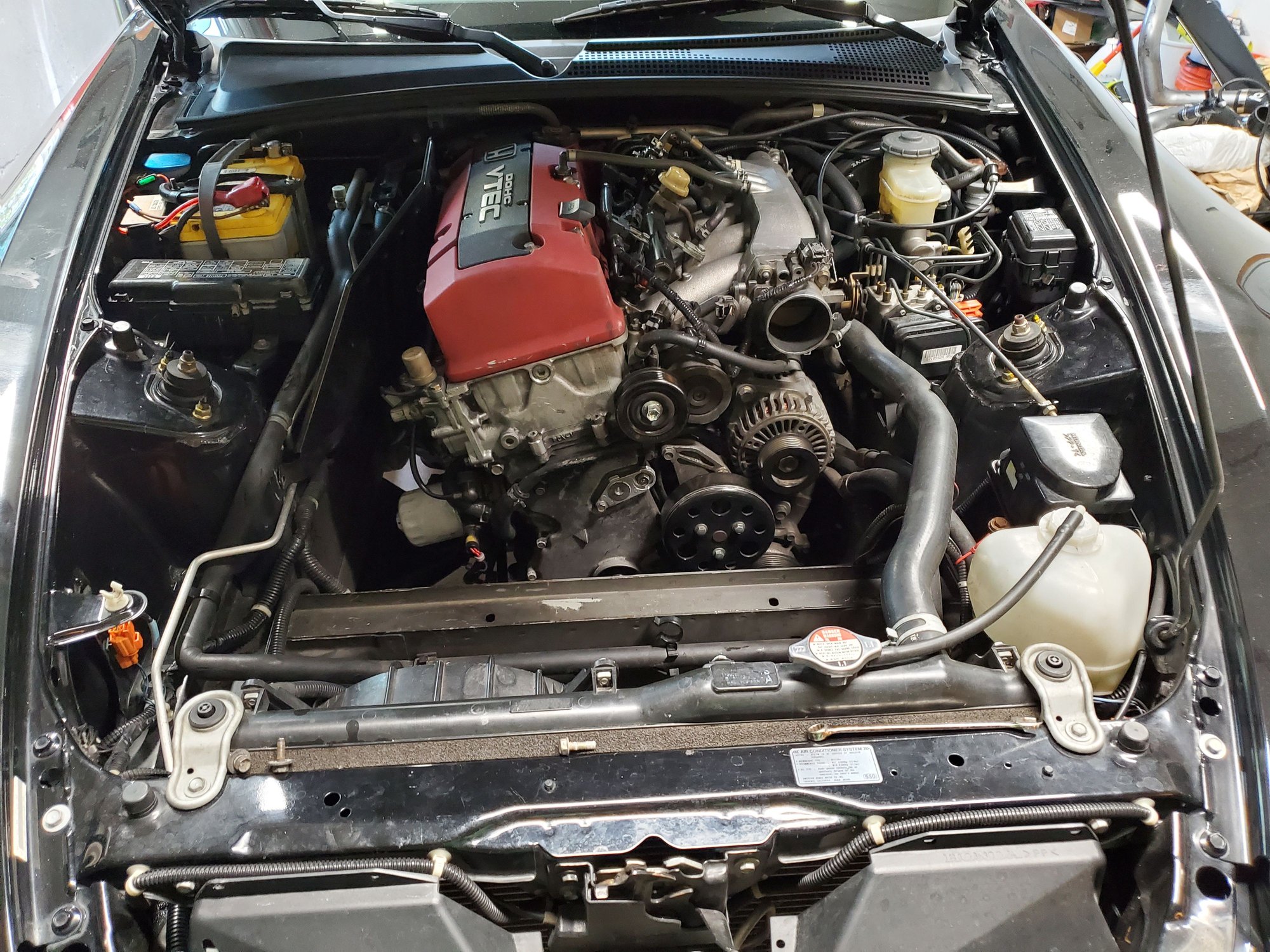

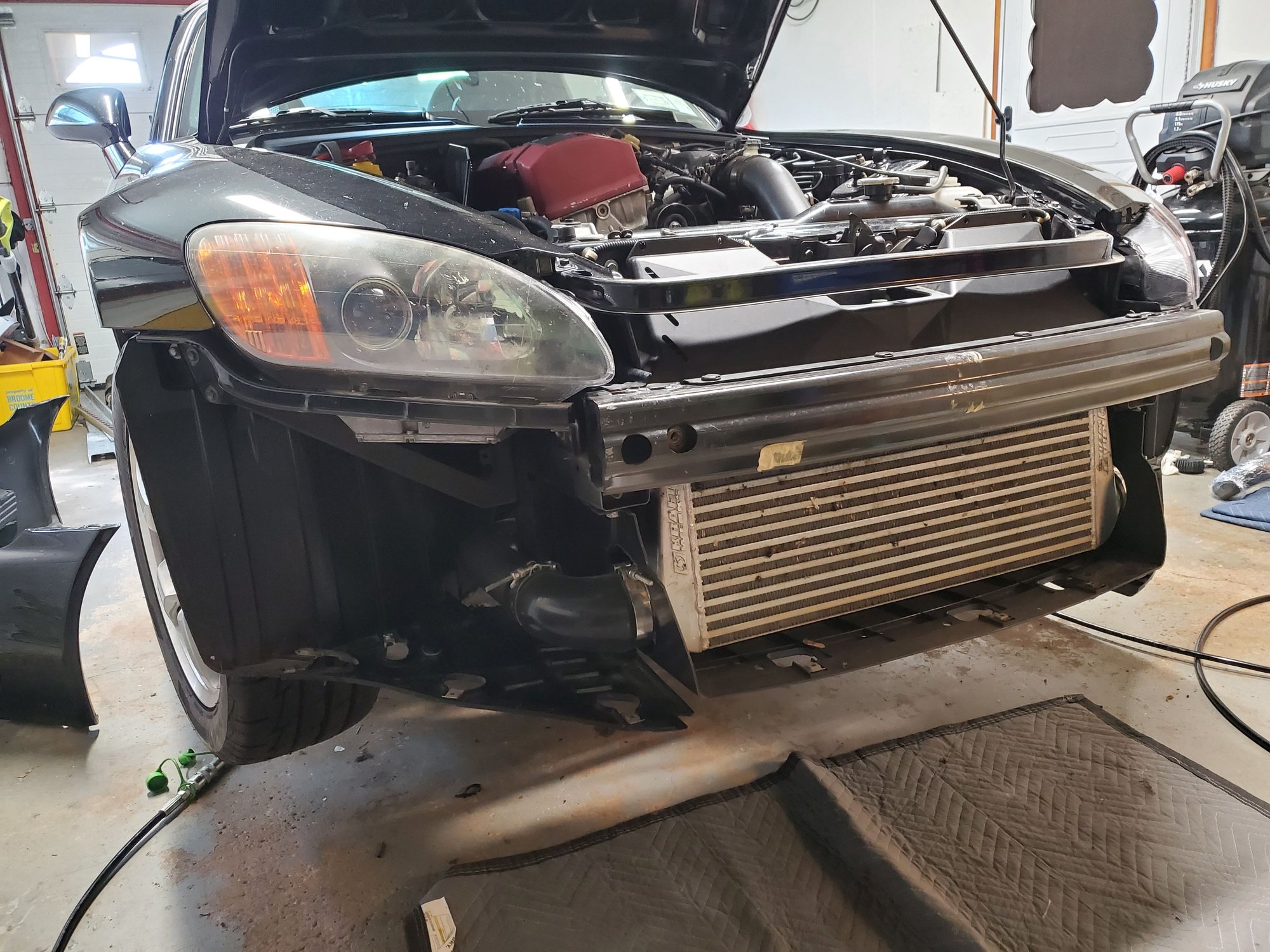

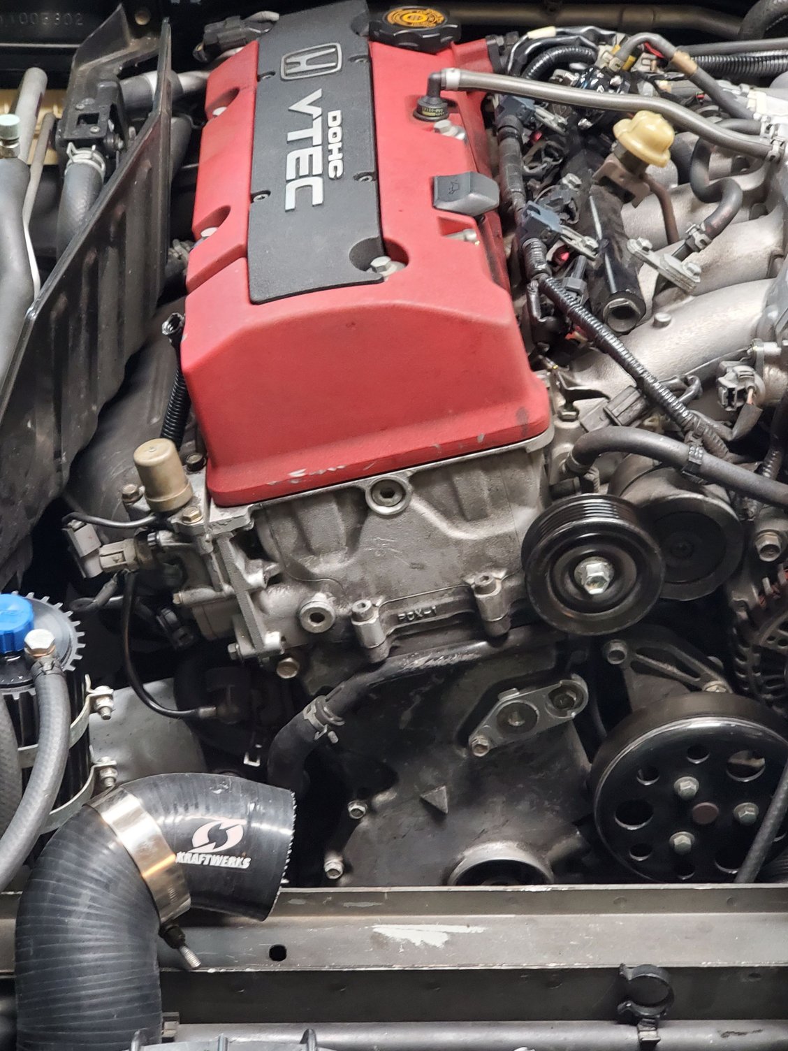

Turned some wrenches last night to remove the Kraftwerks kit.
Next step is to make it stock to pass NYS Inspection... huge annual headache when running a standalone 364 days a year.
Here are some pictures..

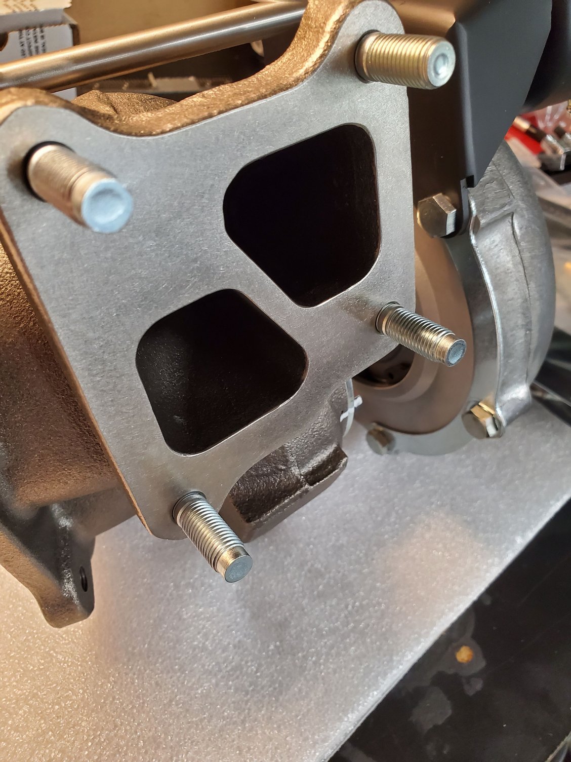

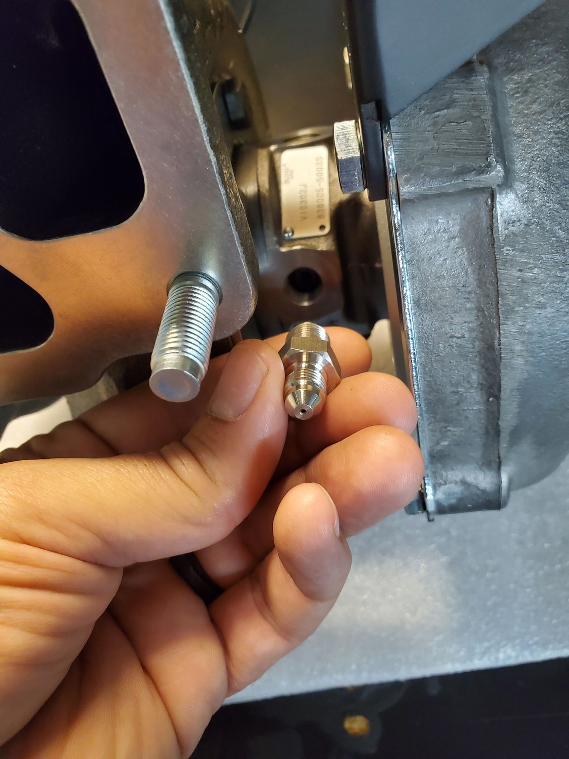

Default Turbocharger preparation

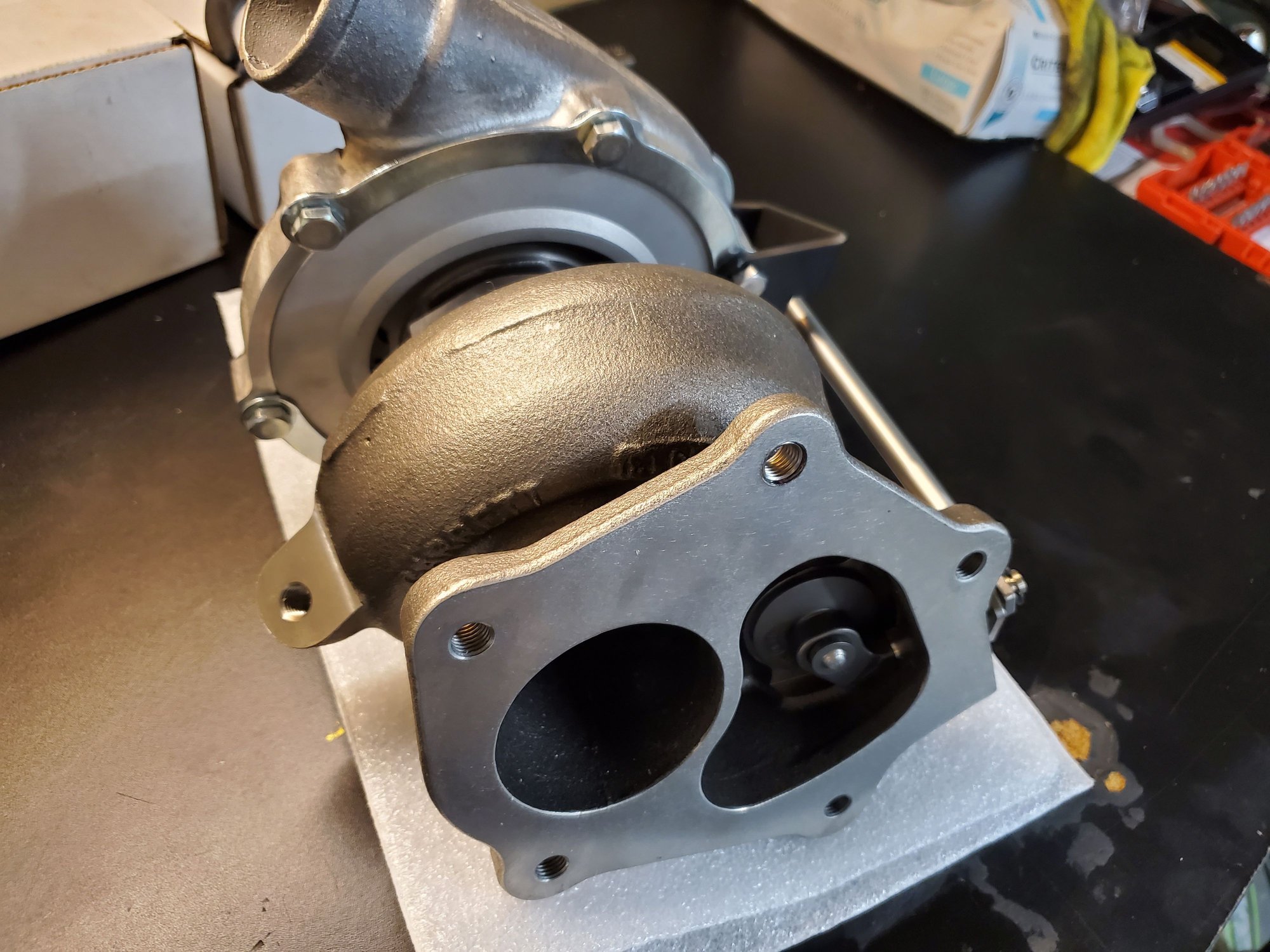

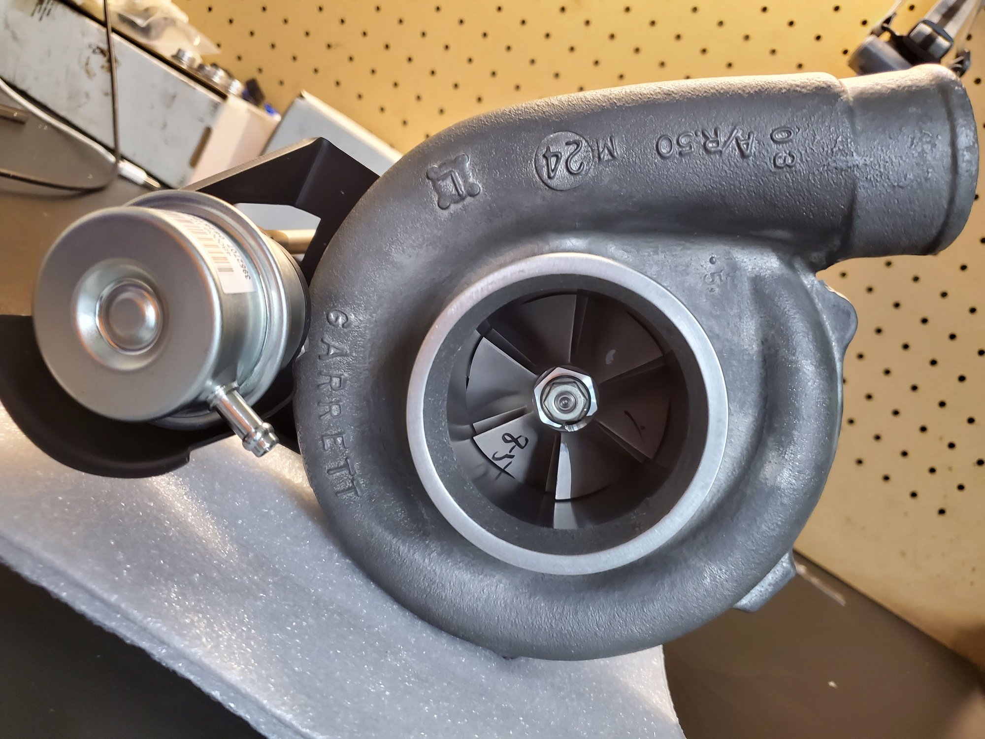

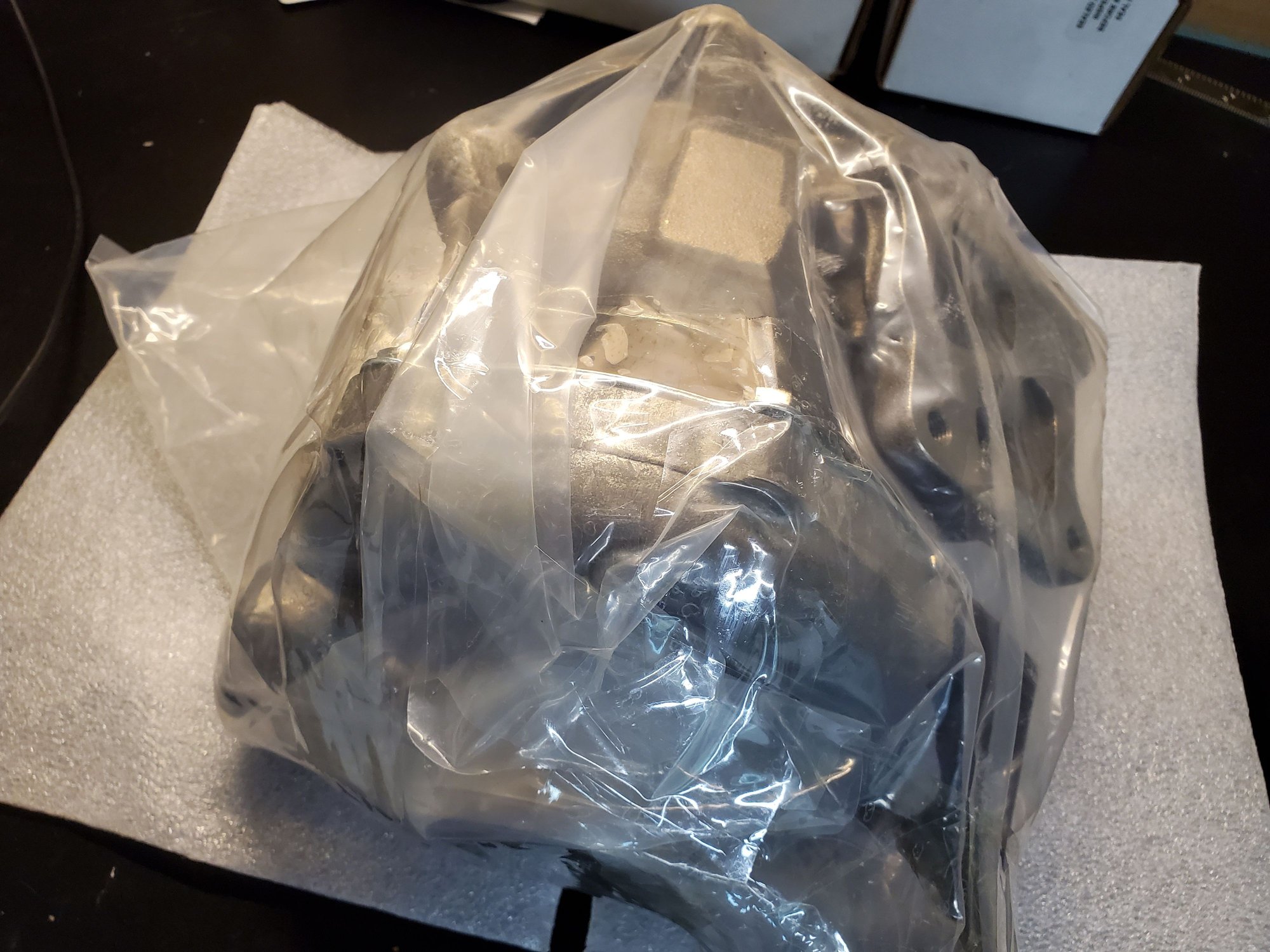

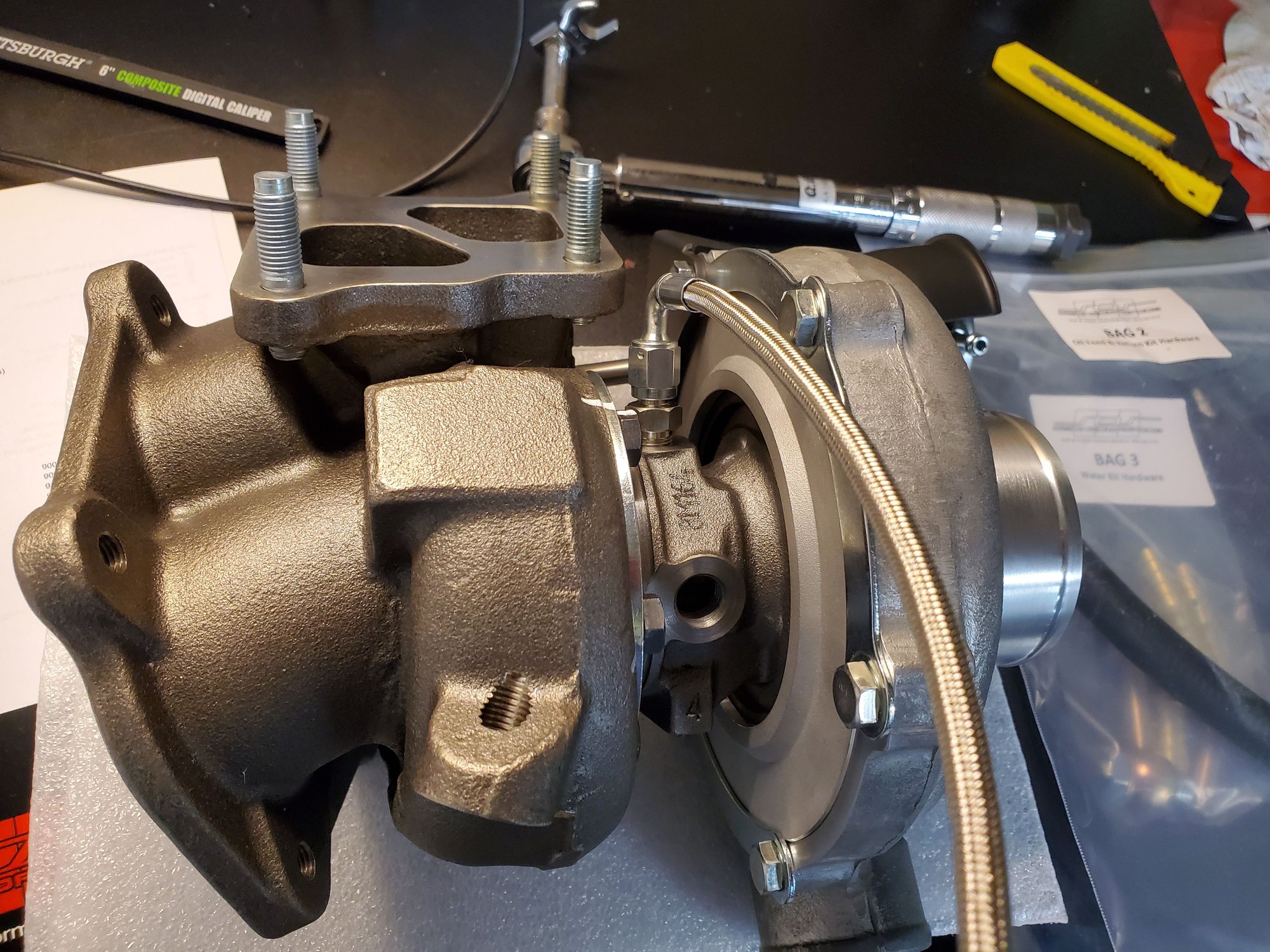

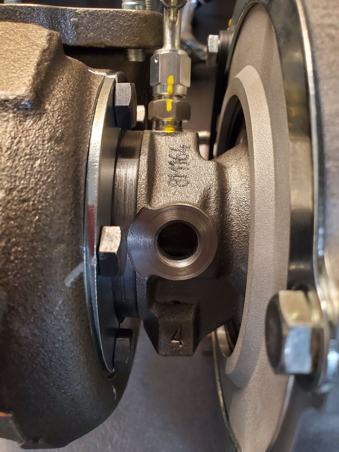

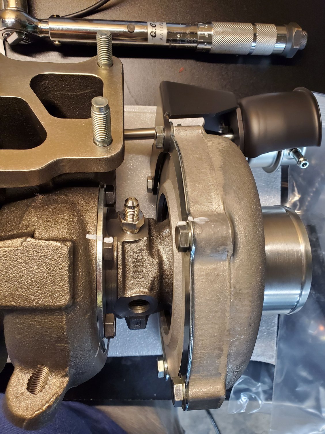

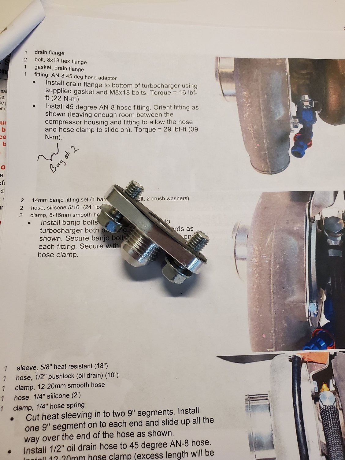

Today I got around to prepping the turbo, pretty much straight forward from the SOS manual.

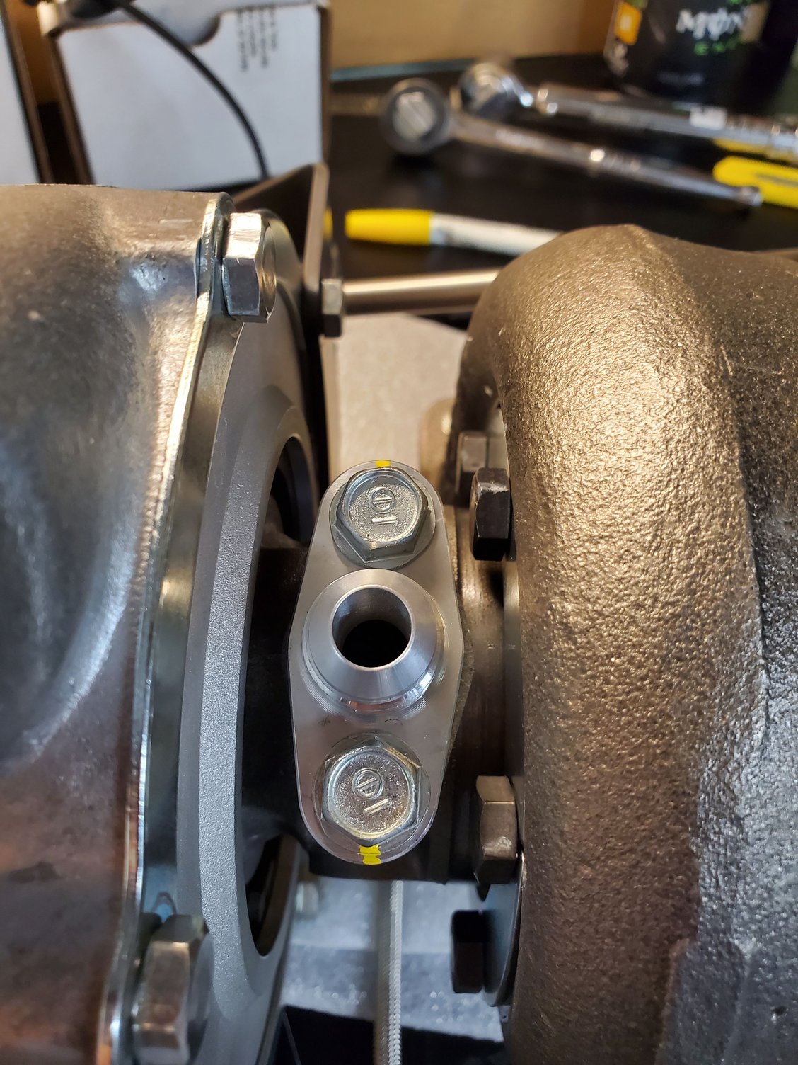

However, the manual did not specify a torque spec for the water banjo bolts. I did some quick research, and found that 29-34ft-lbs will do. I torqued them to 32ft-lbs.
As I torque the fasteners, I mark them in yellow marker to follow the theme Honda marked their fasteners from the factory, you'll notice in the pictures.

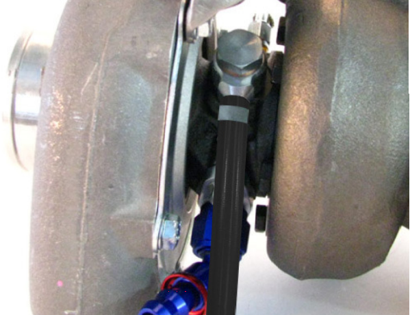

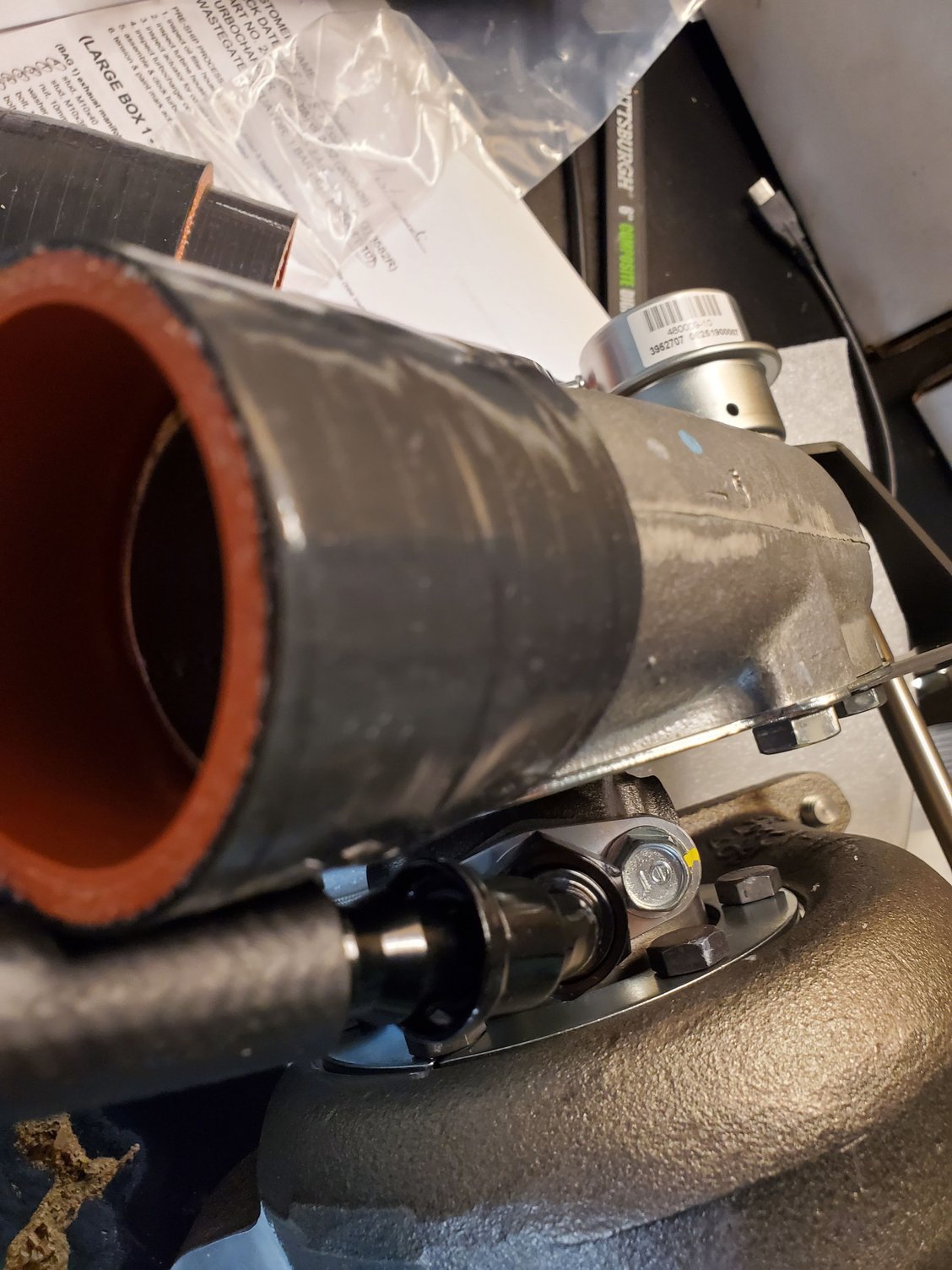

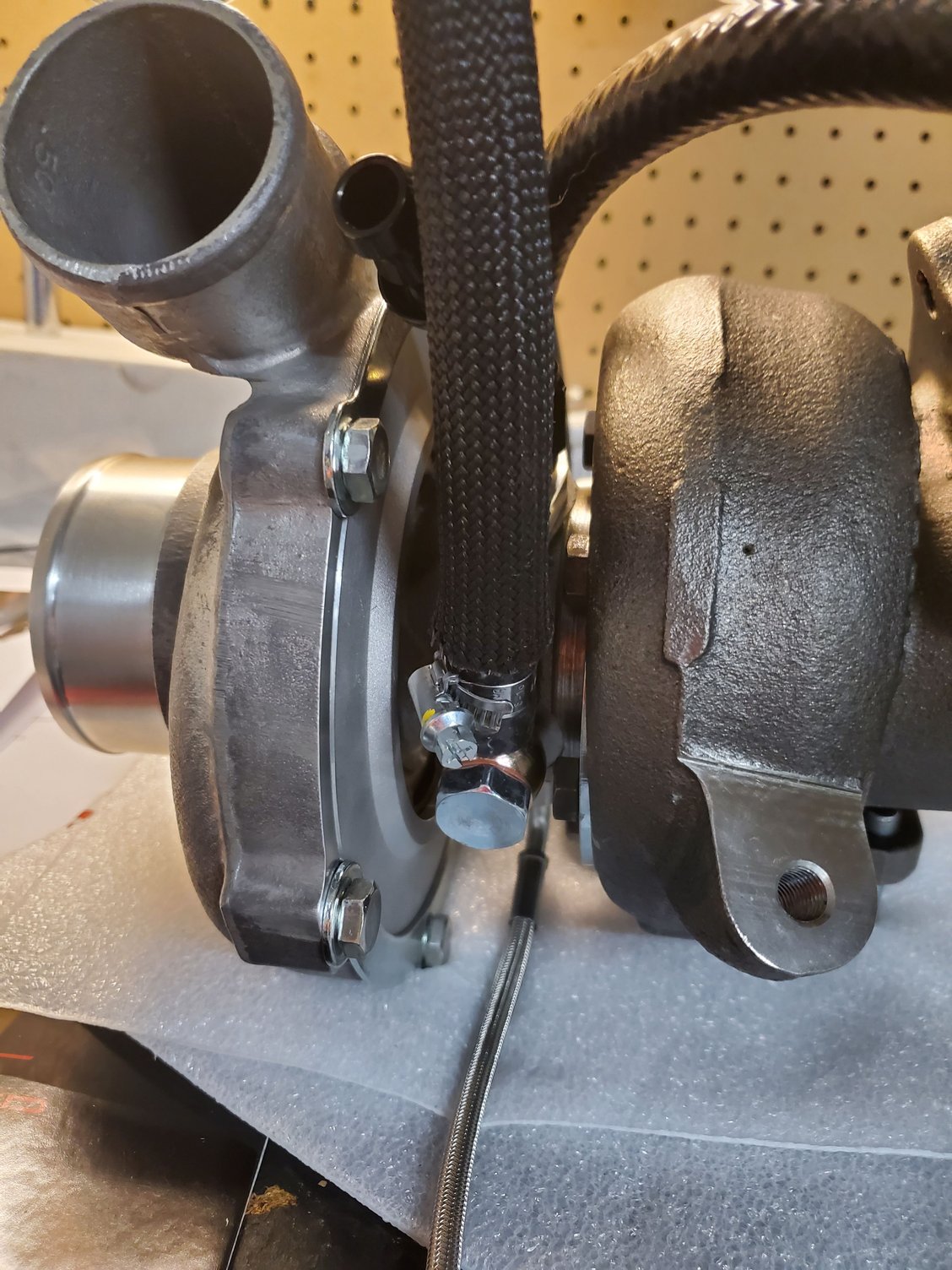

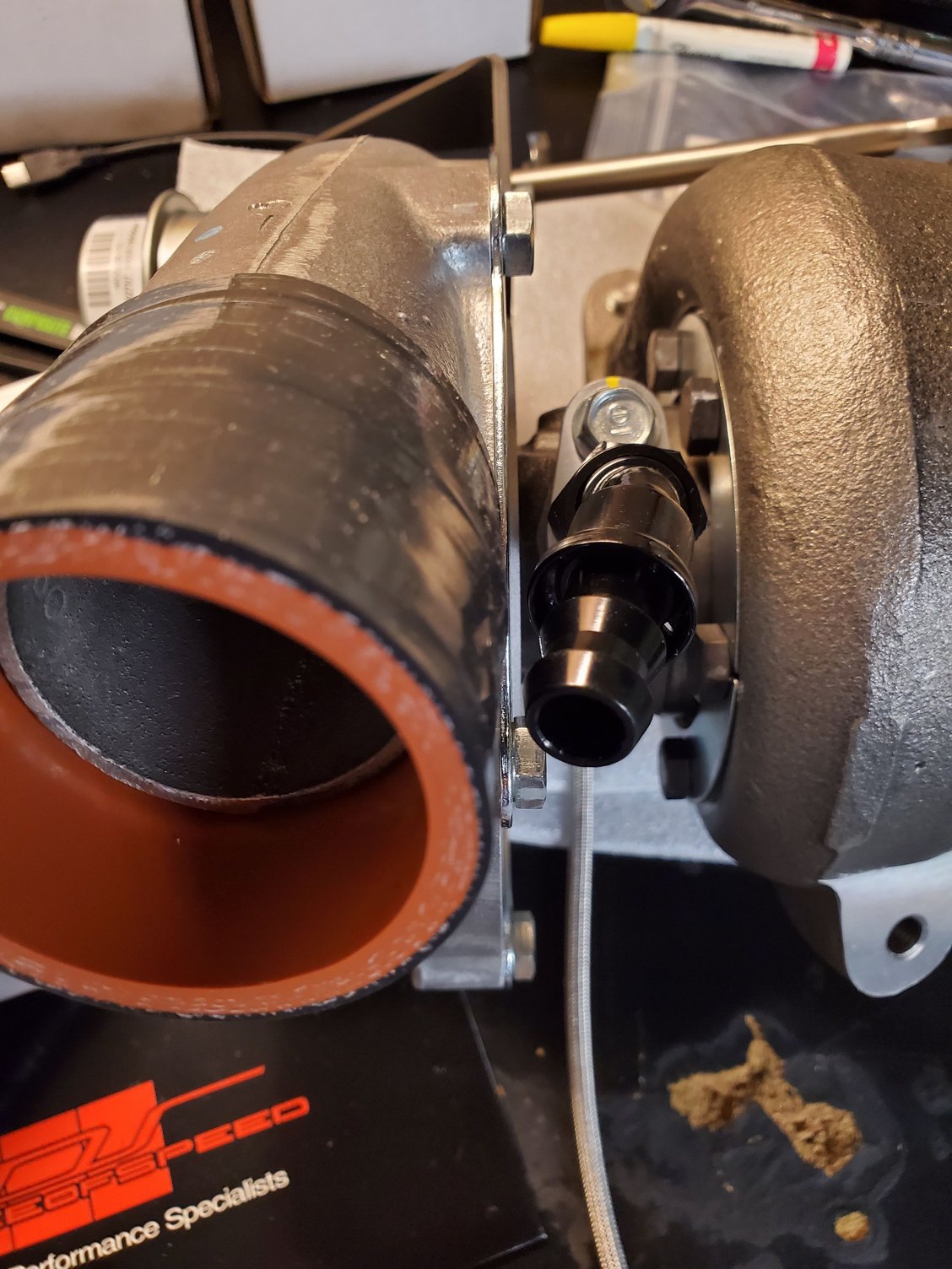

One thing that is different with the kit, than what is the manual is the clamps used on the water hoses. SOS shows a flush fitting clamp in the manual (see bottom two pictures below), and in the kit they provided worm clamps.
The problem with the worm clamps, is they do not allow the heat resistant sleeve to push all the way up to the banjo bolt (also see third picture from the bottom). I feel that may be an issue, since it will leave about an inch of hose exposed to the hottest part of the turbo.
I'm not liking the worm clamp used on the water lines. It doesn't allow for the heat wrap to protect the water line where it would be the hottest area. I would prefer a spring clamp.
Below are pictures from the installation manual. SOS used a different clamp. Expectations below vs Reality above.
