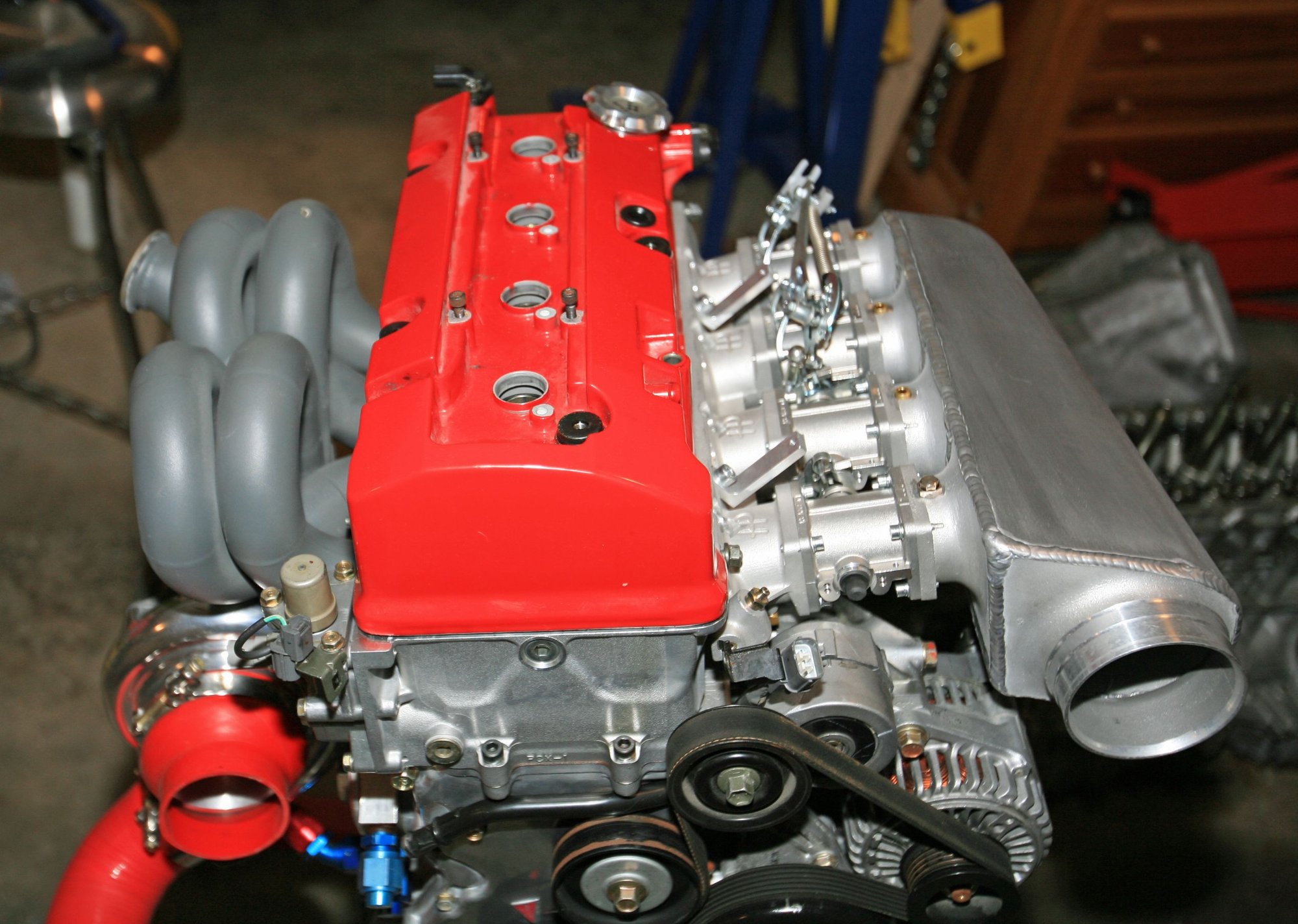

Now, back on topic with a question. I'm having second thoughts about powder coating the plenum. My concern it that it might warp when heated to the 400 degrees required for the coating. Does anyone have any experience with powder coating? Is this a valid concern?

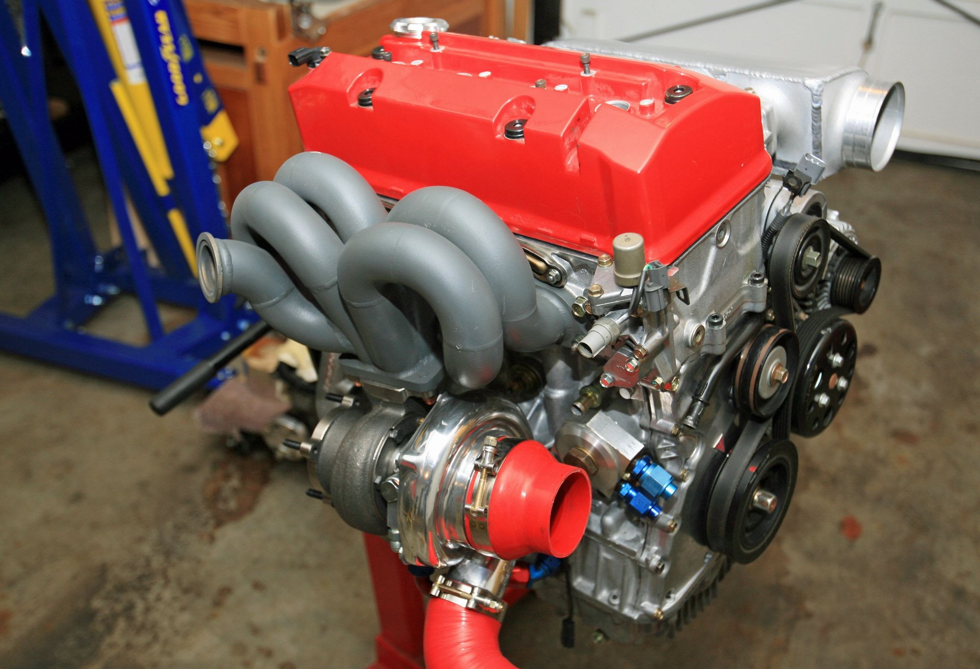

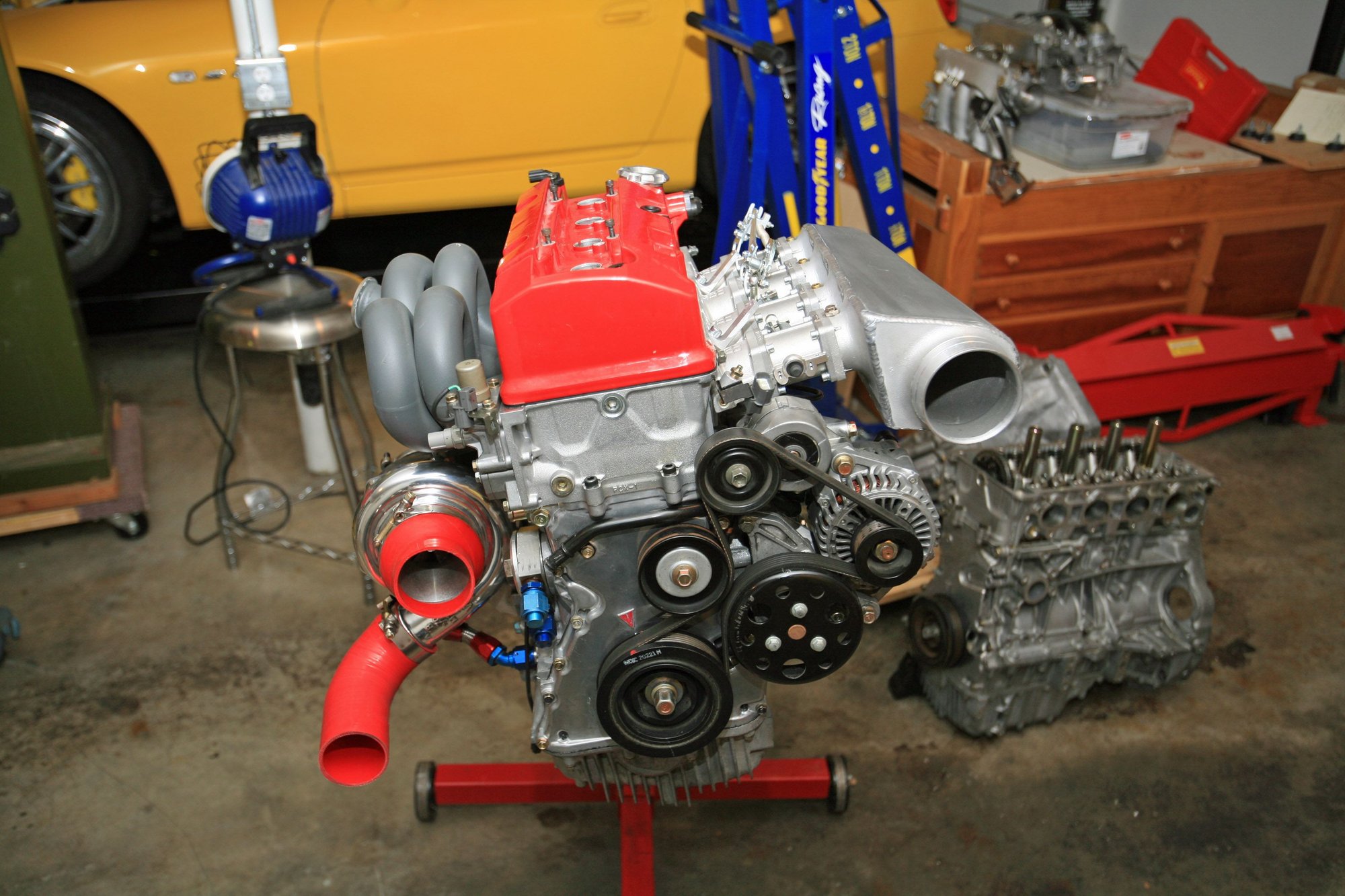

Here are some more pictures with the intake mounted on the engine.

From: NYC
I can't imagine that it would warp anything so long as its heated and cooled uniformly which it should be.
If you are worried may I suggest a Jet-Hot sterling coat. It'll look SO good and it'll keep the heat out.
The Jet Hot coating requires heat far greater than 400*F. I sent my Full Race to HPC tor their 2000* F coating and it warped enough that I had to have the mounting flange machined flat.

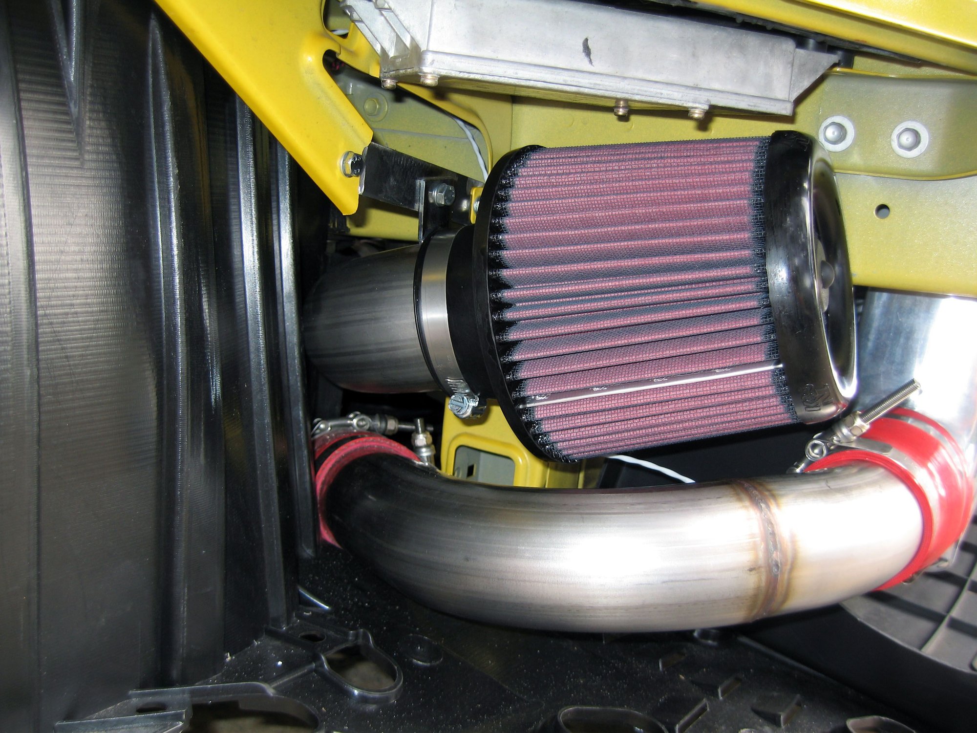

The neckdown is for tubing for a cold air intake. Same as I had before.

Posts: 85
that neck down is basically a restrictor, i doubt the cold air is worth it

You are missing the point. I'm not talking about keeping heat in or out. I'm talking about putting a finish on the plenum for bling factor. The powder coat process heats the parts to 400*F. The Jet Hot process heats the part significantly hotter. The plenum mounts up to the ITB's flanges and seals with O rings. If the plenum warps, the O rings won't seal.
