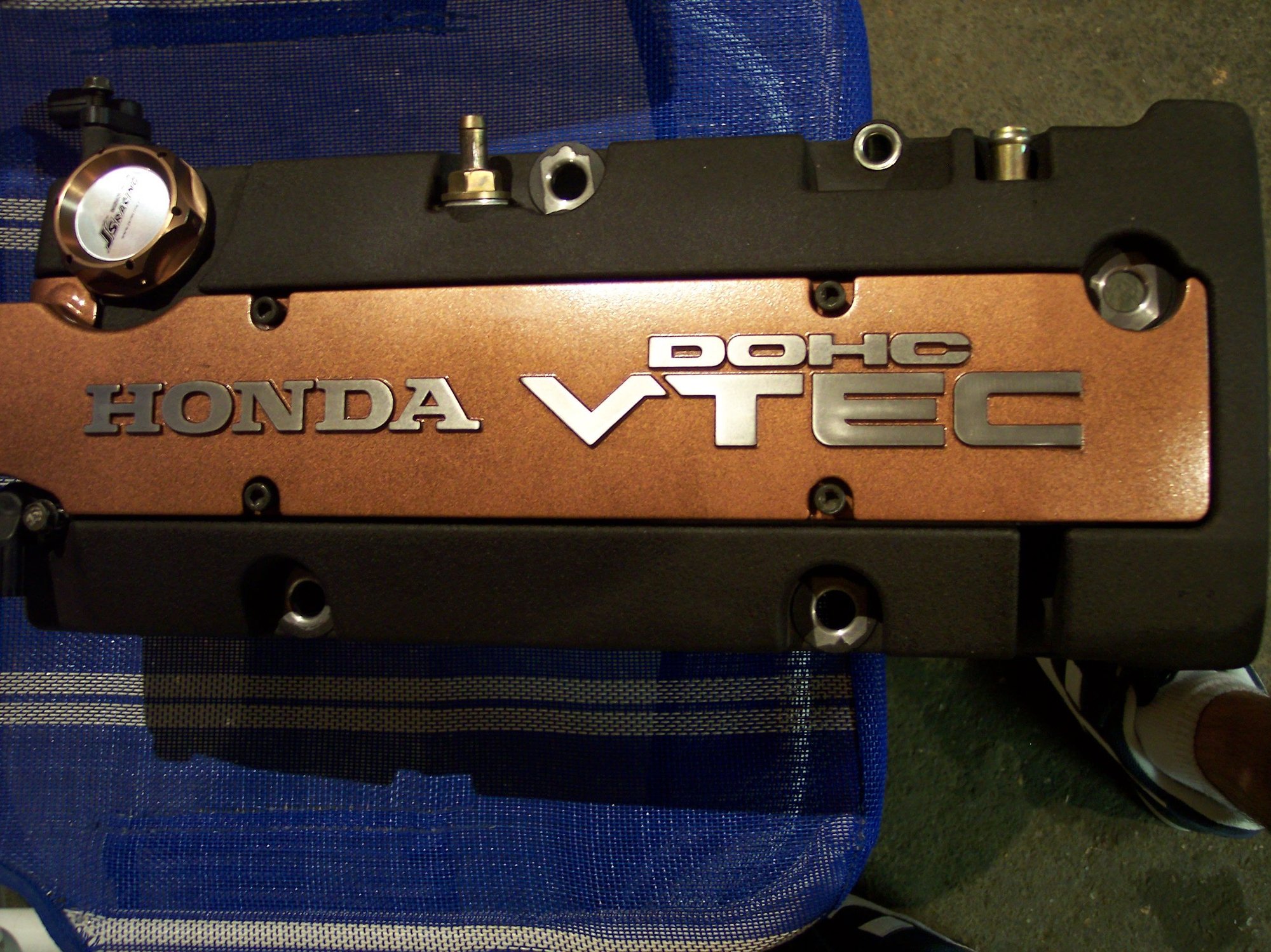

and my custom valve cover for shits and giggles
