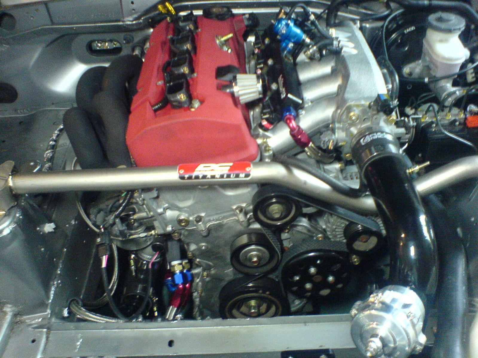

u have to relocate that brake line a few inches, this isnt a great pic but u get the idea, also heat wrap it
