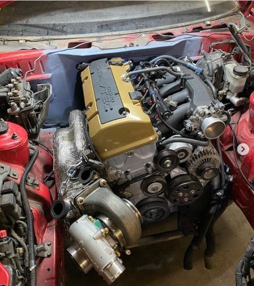

Update: motor is mocked up and so if the manifold, turbo is going to go on, and then we will be test fitting it into the engine bay. Still a bunch of little things to do here and there but it's coming along.

bumping this up, got the motor in the car finally!

What kind of wrapping is that on the turbo manifold? Looks really good. We should compare external manifold temps when you get the car up and running
