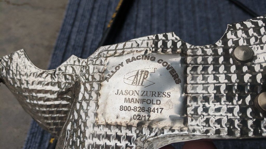

What kind of wrapping is that on the turbo manifold? Looks really good. We should compare external manifold temps when you get the car up and running
It's from this company in Irvine CA called Advanced Thermal Products, they make allow racing covers, will update you on how the external temps are! Really hope they're low because I will be vmounting.
Do they have a template for the full race manifold or did you have to send it in and they customize it? How much? I think that might be the best possible way to go in the end.
https://atpwrap.com/alloy-racing-covers/
It's Inconel heat shielding.
You'll have to send it in. They'll mock up your parts with paper/cardstock and once you approve of the design, they make the shield custom for you.
