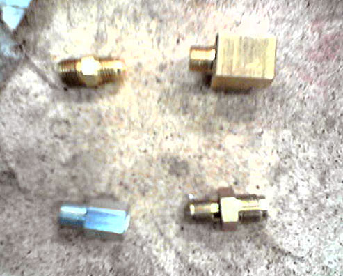

Here's the fittings that came with the Lovefab kit:
Can anyone tell me which one goes into the sump, and which end goes in? I guess the specs of the hole to be drilled and thread to be tapped would be good too.

The way I installed it.
Aluminum fitting goes inside the block from the old oil pressure sensor threads. Big brass fitting follows and bolts up to aluminum fitting. Followed by the smaller (I belive 10mm fitting) which bolts on top of the brass fitting. Stock oil pressure sensor will bolt to the end of the brass fitting. The last fitting will bolt to the turbo between the two coolant return line fittings on the turbo.
I just drilled a hole in the oil pan and use the supplied aluminum fitting that was attached to the adapter line (blue fitting). One side is flat and the other side has threads. Flat side will be welded to the outer side of the pan.
Sorry if this doesn't make sense. Is this correct Coday?

In waht way is this better than the bits supplied with the LoveFab kit? Are any of the threads incorrect on the LoveFab fittings? I don't mind messing threads on the fittings but I don't want o screw with the thread on the block.
Thanks guys. I went out to the fabricators and found the piece you are referring to. The hex end will be welded to the side of the sump with a hole drilled through. The threaded side projects outwards and the -10 AN fitting screws onto it. Makes complete sense now.
The honda block has 1/8BSB while the adapter supplied has 1/8NPT.
Same thread size, but different pitch.
The tunertoys has the proper 1/8BSP pitch.
In other words, they both work, but the tunertoys is the proper fit.
