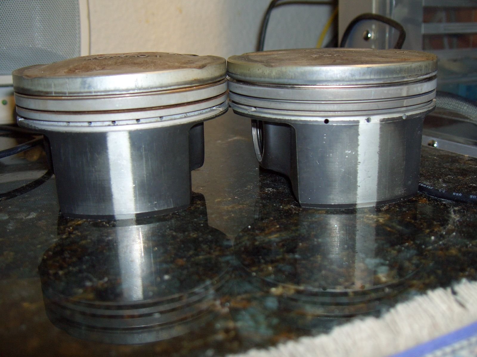

3. Ap2 piston has better oil wiper hole placement. Below the oil wiper rings, see pic.
So if you decided to go with this setup you could benefit from the lower compression ratio, allowing you to run more boost or have a greater factor of safety, all while maintaining the factory quench pads. Also you could benefit from the lighter piston allowing you to spin the motor faster. And lastly you would consume less oil due to the better oiling hole placement.

Ap1 piston is on the left, notice the oil holes are in the middle of the oil wipers.
