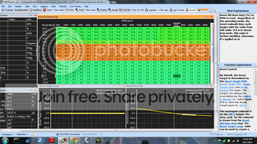

Originally Posted by s2klariat
Wired one wire to 12v switched and the other to d16 on AEM just like it says. When I key car on, fuel pump primes and then the mac solenoid starts clicking and doesn't stop. The wires are not supposed to be polarity specific. When I unplug from d16 it stops clicking.
You can set the solenoid to 0% duty cycle in vacuum. It will start to click when you enter positive pressure.
Here is an example of a solenoid map courtesy of herecomesboost.
Old May 19, 2014 | 04:24 PM
sohc_mshue's Avatar
Joined: Aug 2009
Posts: 876
From: Richmond, VA
If you are using closed loop feedback it will still add duty cycle even if there is no duty in vacuum. Easiest thing is to target 0psi under a certain speed
Old May 19, 2014 | 09:43 PM
5thgen's Avatar
Joined: Sep 2009
Posts: 460
Likes: 90
Is turning closed loop fb on as easy as changing the pro/int gains from zero?
I've just been running off the main table and "boost error duty" table.
