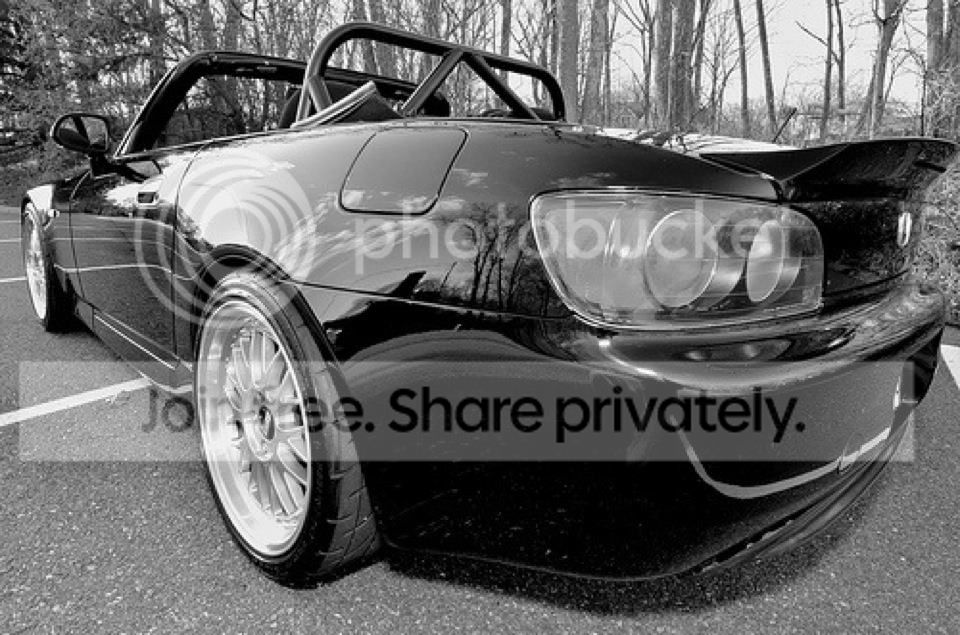

Clean Berlina! Congrats on getting it done! This is with the stock FRM built motor right?

Thanks everyone. We still have some tweaking to do, the hd roll bar and harness will be put on over the next few weeks then I'm preping the car for the dragon. As it sits now it's a blast to drive. Jeff did a great job with the tune. Off boost the car drives just like stock, zero hiccups so far. My hi/low boost is controlled through my cruise control on/ off button. Low boost is set at 8 psi around 350 whp and that feels great for everyday driving. Hi boost is boost by speed and reaches 18 psi by the top of second. It's been a bit cold around here in ma so I haven't really driven the car hard yet but I did do a few quick short shifting pulls on the highway and the car feels very strong.
^yes this is a stock frm build. I haven't seen anyone here go this route yet, so I will offer as much feedback as I can if any issues arise.
