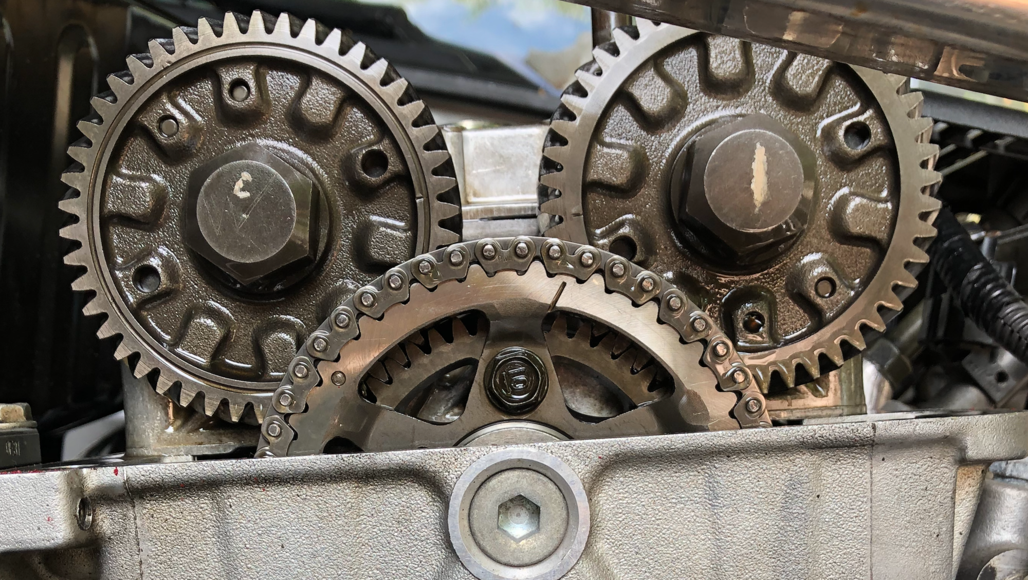

After a valve adjustment my car was running pretty crappy. A friend suggested the timing might be off, so I checked, and it seems to me he was right. What do you guys think?

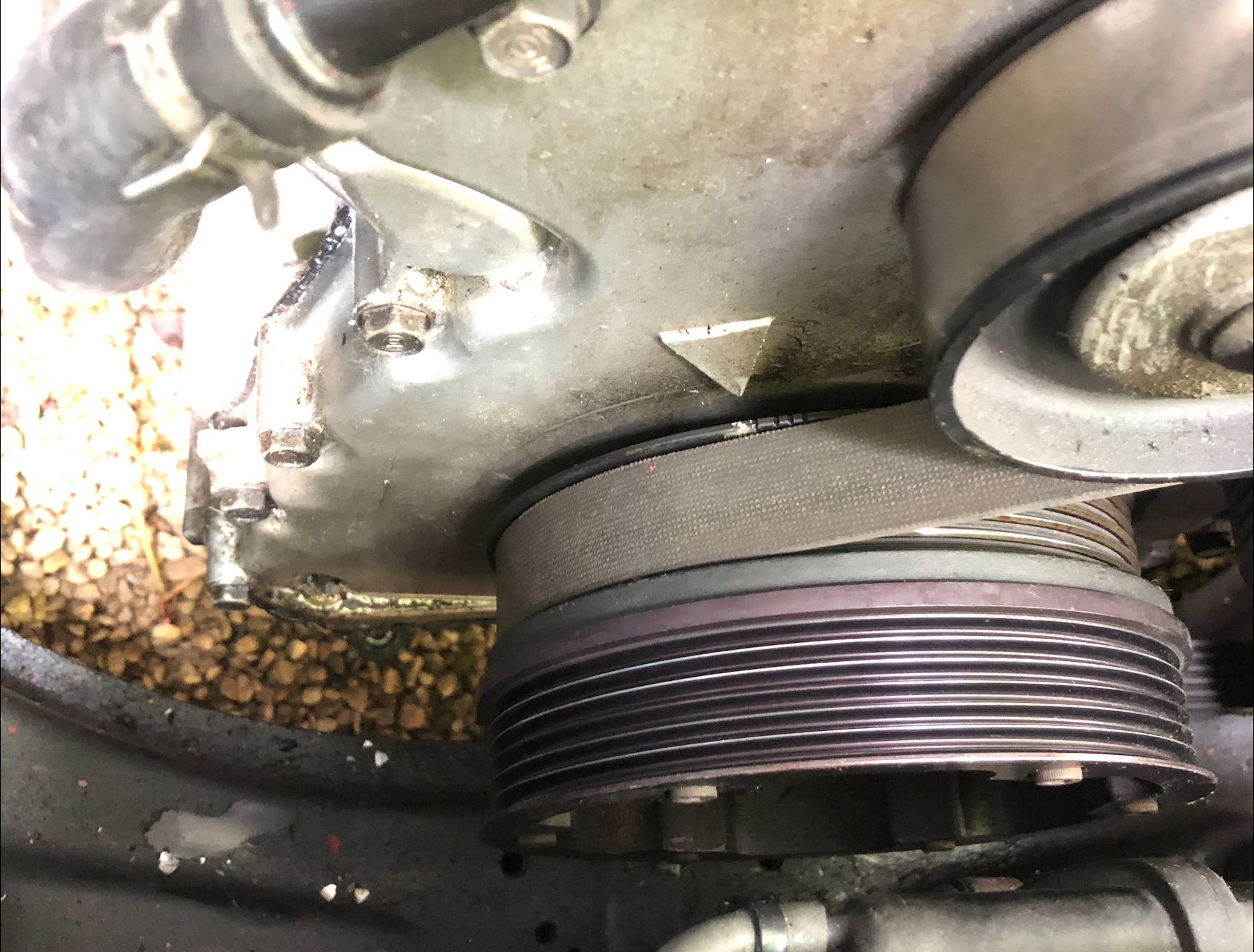

First set of pictures, I've aligned the crank pulley correctly. And the camshafts are one tooth misaligned. Here are the two pictures.

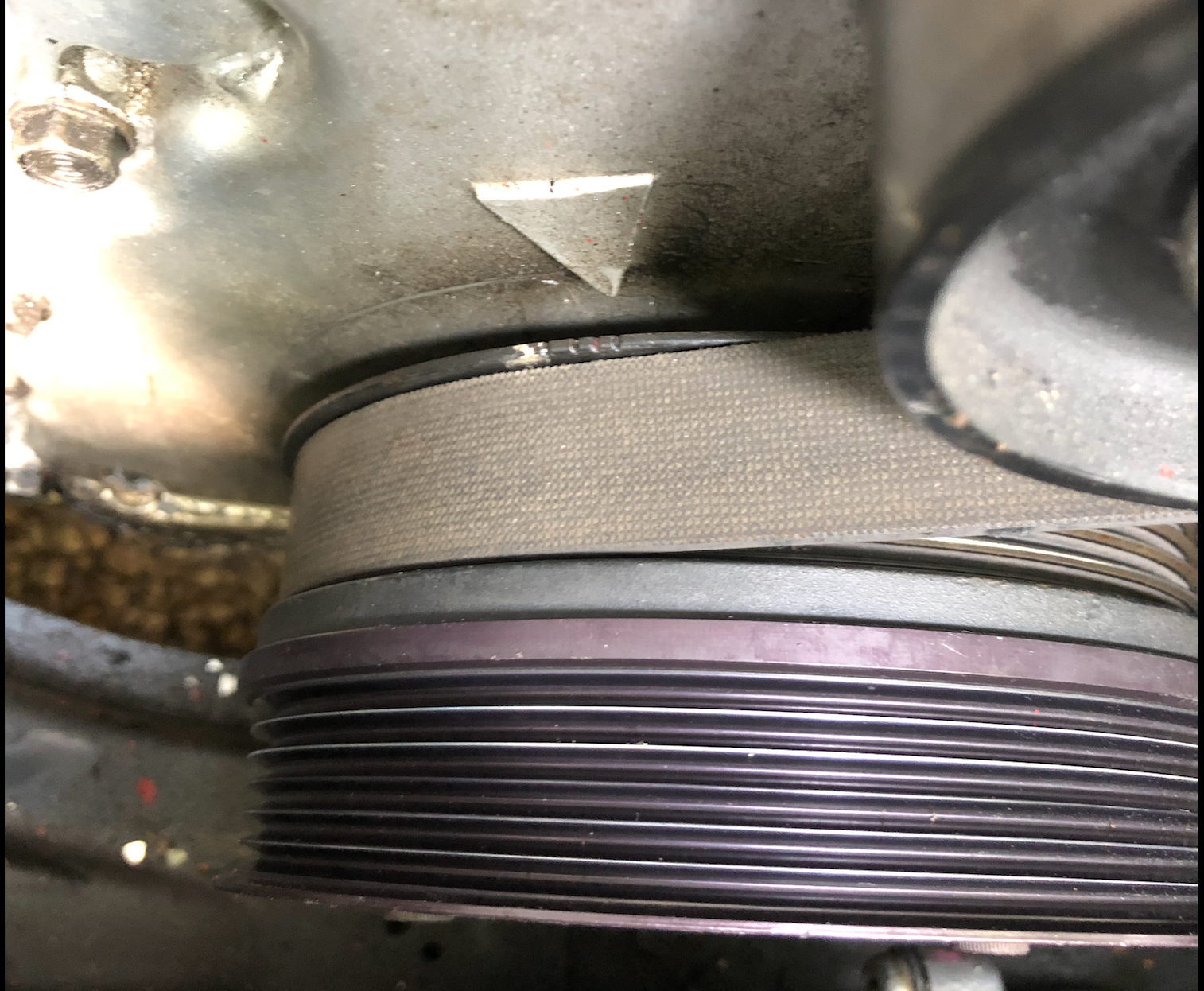

Second rotation, I aligned the two camshafts and the crank pulley is now off.

what’s been done to your car? Has your timing chain ever been off? Just installing a SC kit doesn’t change the timing
Now that our cars are getting older there have been some cases of the rubber cracking/separating from the pulley itself. There are a few threads about how the timing marks weren’t lining up because of their worn out crank pulley. Since you mentioned Comptech I will assume you have an old kit with an older crank pulley so it would be worth closely inspecting yours

The marks on the cam idle gear was way off even before you aligned the cams so someone for sure has been messing with it before.
Make sure your crank pulley hasn't separated like in the links above. Probably should remove it and install a "new" one without the additional SC pulley.

as Flanders states get the idle gear and correct cam timing as link below so may want another crank pulley it seems
https://robrobinette.com/S2000ValveAdjust.htm

The idle gear is the "big wheel" in between the camshaft which has the chain on it, correct?
I see it's not aligned correctly, but that doesn't really matter, as long as the camshafts and crankshaft are aligned, right?

Its There for a reason <TDC>

No it doesn't matter as long as the crank and cams are aligned.
