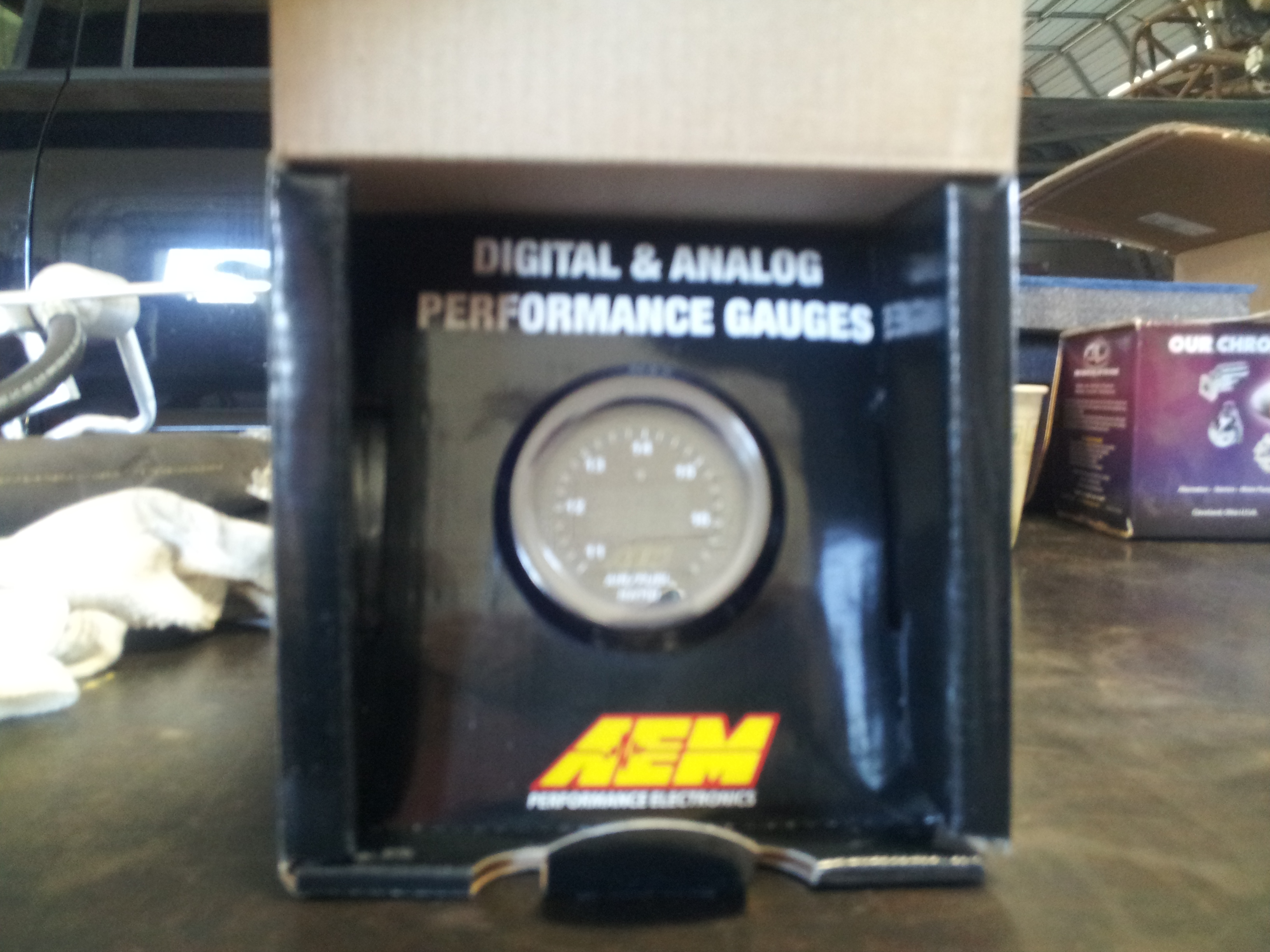

AEM EMS series 2
AEM truboost gauge
AEM Wideband gauge
