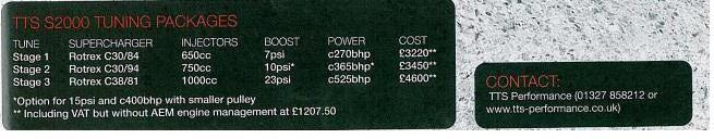

You will have to do your own testing on your F22's to see what's possible. I have 450 at the wheels with no w/m on my F20, but with m/w you can up the ignition adv and get much more as it ups the octane and lowers charge temp, its vertually free power.

Want more info on *15 PSI Pulley??? Pleaase
Can you run a 15 psi pulley on a C30-94 with a f20? Or am I reading that wrong?

15psi would destroy the c30 fast. everyone should just jump right to the c38 @ 23psi and put a wastegate on the sytem to bleed off boost above say 14-15. that would be a sick pump gas car.

[QUOTE=CourageOO7,Jun 17 2010, 11:42 AM] Man, that stage 3 dyno looks sweet.

Originally Posted by 9KRDLIN,Jun 18 2010, 01:05 PM
I am flying the BS flag on that stage 3 dyno chart. the most very basic of the formula to make the hp number based on tq is completely wrong on that chart.
without going too much into it, hp and tq have to cross over each other at exactly 5252 rpms. stage 3 kit shows it cross at 4200 rpm. it also shows the tq continue past the hp. if that were the case, the hp would've touched 460+ hp. someone needs to clarify.
