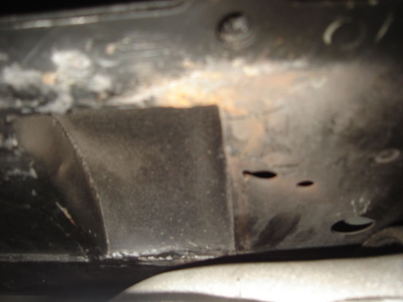

ne one going to add n e thing in on frame cutting. Can anyone show me pics? I am in need of it, since my turbo is sitting on the frame wall.....

PM OGPackin. He has pics of how his frame was notched.
Here you go....

ohhhh i seeee, wow, how is that done? And with what tool? cause my shop was planning to just pound it in. Tell me before monday, cause they are kinda stumped. thanks.

From: Boca Raton
They cut the frame with a tourch. Then fabbed up a piece of metal to fit the cut out and welded it.

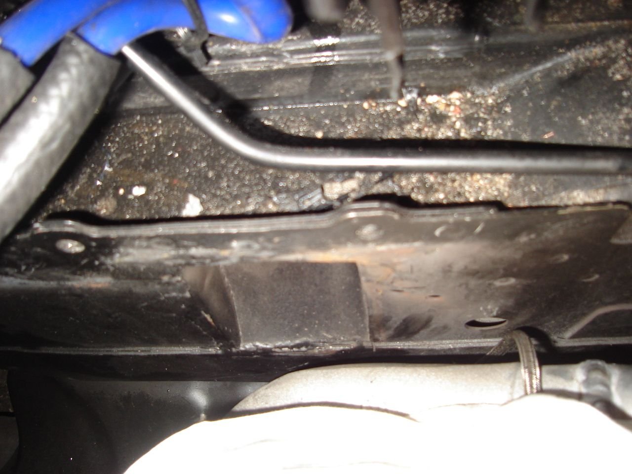

Okay here is an update...
I got my car back and it was making these horrible vibrations that i could not take. It seems the turbo was sitting on the frame of the car. I got them to cut a square to let the turbo not vibrate the car. It is only very small of a vibration now, i would not even call it that, when it is in nuetral at a stop light. Besides that the car has been running fine these past few 100 miles. I got an oil change and waiting to hit 500 miles soon for my last oil change. After this I am going to get this thing tuned at 2nrwerks. From what it seems this car offically has become a tuner car and is no longer, the humble car I once knew. It will not be my daily driver. At least not drive THAT much anymore. Doesnt seem that the turbo is going to make this car anymore civil. So i will update later on with the tune in Tampa guys. Thanks.
