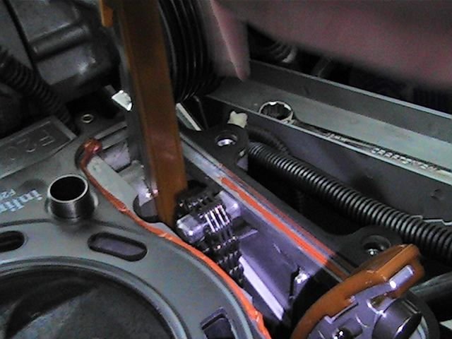

All that was left was to install the head gasket itself and then the head on top of it. The first thing you want to do is put 2 small dabs of RTV or hondabond at these points on both sides of the timing chain case. The head gasket goes on top of these so you dont want alot just enough to ooze out and make a tight seal.
Set the 3mm HG in placemaking sure it is lined up by using the dowels that fit into the block surface to keep the gasket in the right spot.
Now its time to add more RTV / Hondabond to the area around the timing chain case. I used the Ultracopper RTV you can buy at your local autozone. It works just as good as hondabond in my opinion. Put a small bead of the gasket maker around the top of the timing chain case making sure it stays at lease 2mm away from the edges.

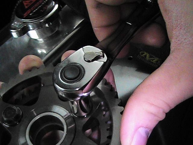

Once torqued down you need to install the cam timing gear. This needs to be "clocked" to allow for the thicker head gasket. Simply remove the three bolts that hold the timing gear to the cam gear and then using a punch and a hammer drive the set pin out of the timing chain gear. Then re-assemble them loosely. Once at this stage rotate the front gear as far clockwise as you can (about 1mm further than with the set pin in place) and torque the bolts holding the gears together back down. This adjusts the timing to the stock settings and allows for the thicker head gasket.
