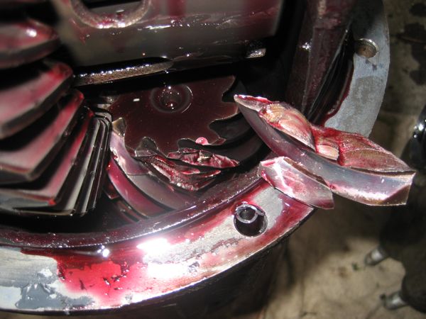

Good to hear it was just an axle. I was not so lucky this holiday weekend. Just drained the diff and there's metal everywhere. Anyone have a low mileage ap2 diff for a good price?
