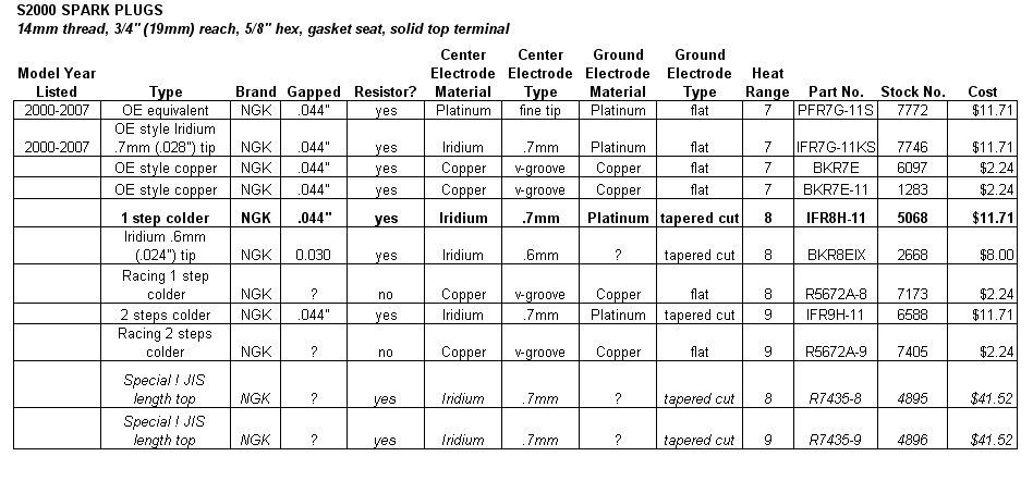

I did some spark plug homework, glad I did. I think I'll go with the IFR8H-11 plugs instead of the BKR8EIX.
and why's that?
I think I'm going with the BKR8EIX for the iridium.

Only because the IFR tip is laser welded on, and although its still a small tip it has much more attachment area (.7mm vs .6mm). I don't know if I trust the .6mm tip, plus it looks like NGK is recommending the IFR over the BKR.
Even so, I'm sure the BKR works fine though, so its just my preference.
where are you buying your plugs from?
http://sparkplugs.com/results_cross....R8H-11&x=0&y=0
The site says "We do not have an automotive fitting for this part in our database." and only applies these plugs to atv's and bikes. Someone help me cuz I need to buy 1 step colder NGK iridiums for my car. Thanks!
They're the same, im buying the same plugs, you can get it from advance auto, or order it online from amazon.com(yeah go figure, amazon sells them, lol).
