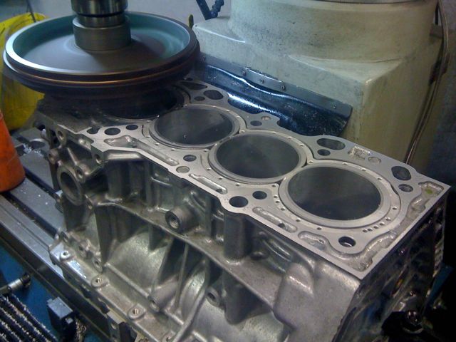

Picked up my bored block last week and took it to the factory for decking.
That's standard sleeves bored out to 87.5mm and a Supertech blockguard.
I'll start reassembly next weekend.

For those with a keen eye, you can see that the block surface is slightly depressed between the cylinders leaving a black telltale line. All the bores were also around 0.001" lower than the edge of the block.
It took about 0.004" material removal to get the block surface flat.
So Aus, any pictures of the assembly?
