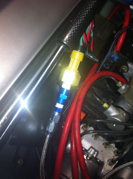

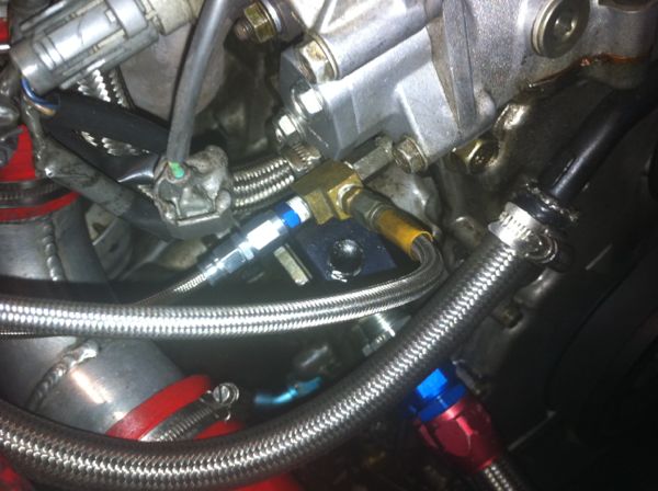

I have an AEM Brass Oil Pressure sender/sensor I wish to plumb in. It's 1/8th NPT so will screw right into my block. But as that is where I T off my oil supply to the turbo there is already a brass fitting there and I have been warned not to have too many brass fittings off the block as they can become brittle and crack which would lead to catastrophic failure.
So to remote mount my oil pressure sensor requires a short length of braided hose (suitable for oil) with 1/8th NPT male at one end and 1/8th NPT femail at the other. And I'm guessing it needs to be between 15 and 20 inches in length.
Is this correct? Who else has remote mounted there oil pressure sensor and what did you use? And where did you source it?

Earl's came to the rescue!
