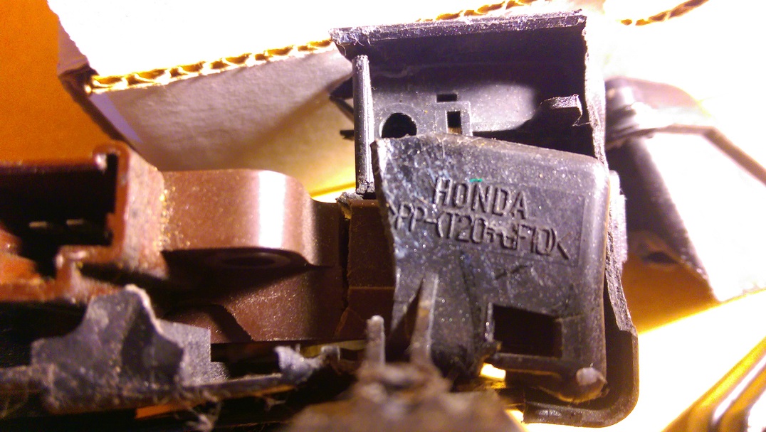

ok well i figured out that was not the resistor box, does anyone know what this is? it seems to be broken and im trying to find a replacement. thanks
[attachment=62100:1.jpg]
[attachment=62101:2.jpg]
[attachment=62102:3.jpg]
it says honda >pp-(t20+gf10)<
did a search and figured its not the AC blower unit, not climate control unit, not power steering, not cruise control.
Any ideas?

Old Jul 4, 2014 | 05:01 AM
starrman's Avatar
Joined: Feb 2011
Posts: 1,256
From: Eastern NC
I would have to agree...with what is visible in your pics, I would guess there is more carnage elsewhere. Just start fresh.

Maybe its alarm system that Honda sell in accessory

thanks for all the suggestions i finally found out what it was. Its the ELECTRONIC CONTROL SENSOR CASE ASSEMBLY.
That is what I was thinking it was. Normally this is inside the drivers front fender. if it is what I think it is.
