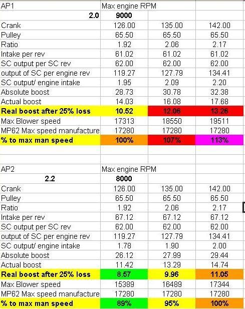

7-12 deg F above ambient! That is nothing, how many PSI is safe to run without over spinning the blower?

the Air to water IC is designed to be used on 500whp vehicles there is so much head room (lots of surface area) the temperatures coming out of the unit are unreal the efficiency of the A to W is pushing just a little over 90%
This should help you understand the relation ship between pressure and speed of a roots.
I need to adjust the models in this spread sheet to reflect the real world outcomes of the current beta kits. The pressures you see here assume standard intake temperature and intake pressure that the blower was tested at (when at the manufacture) to put out 62cubic inches of air per rev.
