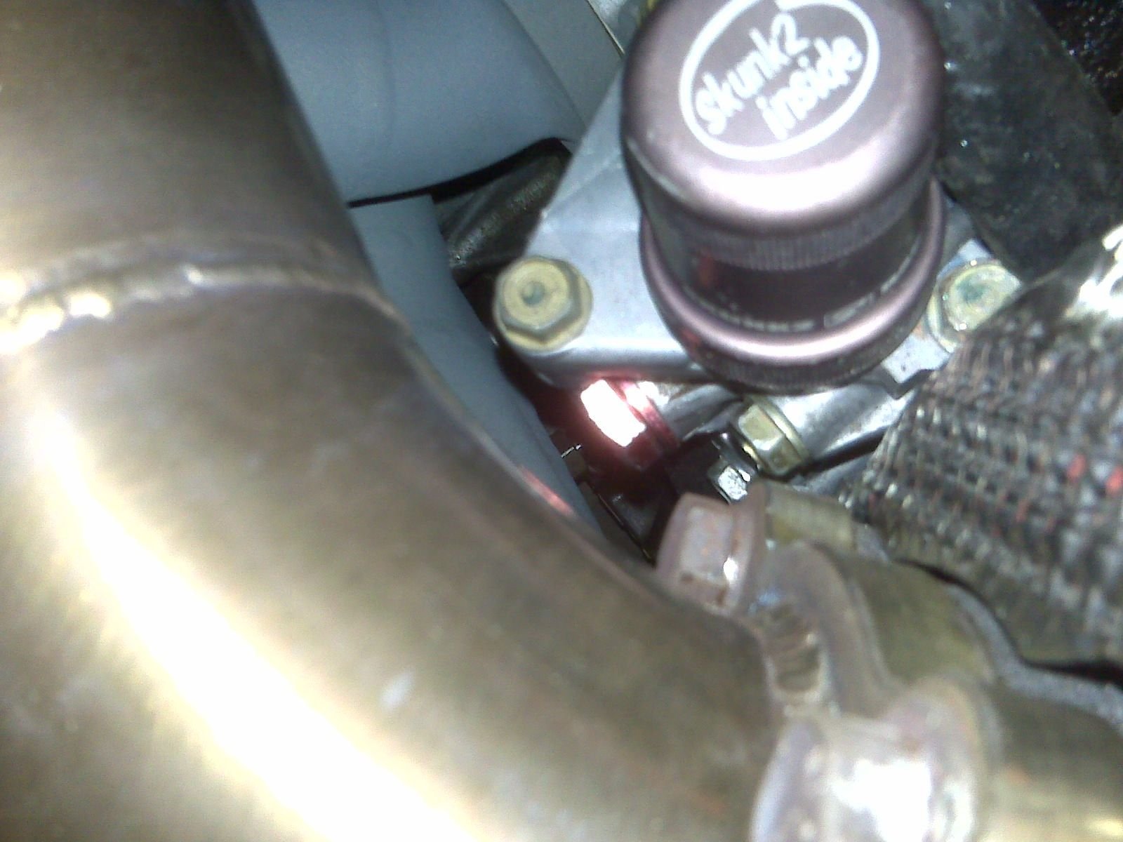

Yeah, you just take the sensor to an auto store that has various bolts and get a bolt that matches the sensor threads and also get a washer with it. The bolt may be quite long like mine was and you may have to cut it down to about 1/2" of thread length. There is an oring seal under the sensor and you will leave that on the VTEC solenoid and use it with the bolt. Also, take a little bit of teflon tape and put it on the threads of the bolt youre using to cap the hole to ensure no oil will leak past the threads.
Here is the best pic I could get of mine and I havent had any problems with leaks with the way I mentioned doing it above.
