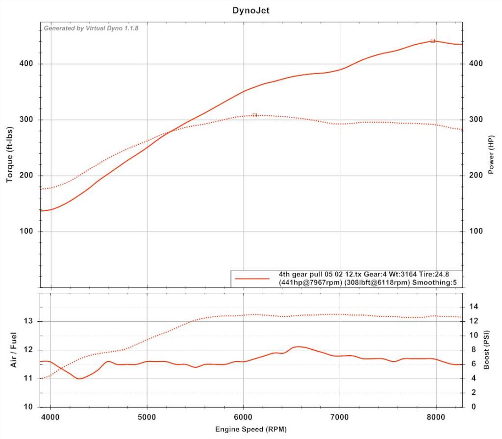

Virtual dyno sheet. Iv'e read some reveiws online and for the most part it seems to be somewhat accurate Boost is limited to 7.5psi until 60 mph to keep 2nd gear from grenading.
Nice to see someone else using the software. I'm not brave enough to do 4th gear pulls.
In your dyno plot, are you shifting gears to get to 4000rpm? or was a straight 4th gear pull?
Usually, I would let it get up to 2000rpm in first gear, shift into third and let it go WOT. It would build boost slowly, but I get consistency every time.

Originally Posted by indi00
Nice to see someone else using the software. I'm not brave enough to do 4th gear pulls. ?
First time I saw anything about it was in your DIY tuning thread. I've only run a few data logs with it but it seems fairly consistent. I like 4th gear because you get more resolution in your data logs. I only do 4th gear pulls if no other cars are around and make sure I won't be passing anybody. 4th tops out around 110mph so it's not that fast really.
Edit: Started in 4th gear at 49mph according to my log.
