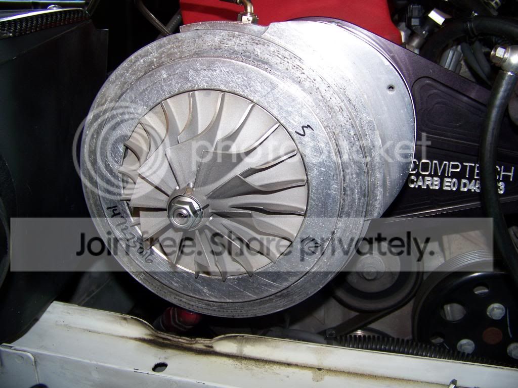

Can one of you please post a picture of what you are talking about. I'm trying to find a leak but I'm not very technical. Thanks!

Found the picture...now irrelevant... Again this is a Novi 1000
The seal is a LARGE thin o-ring that goes around the out mounting area between the sc unit and compressor cover.
