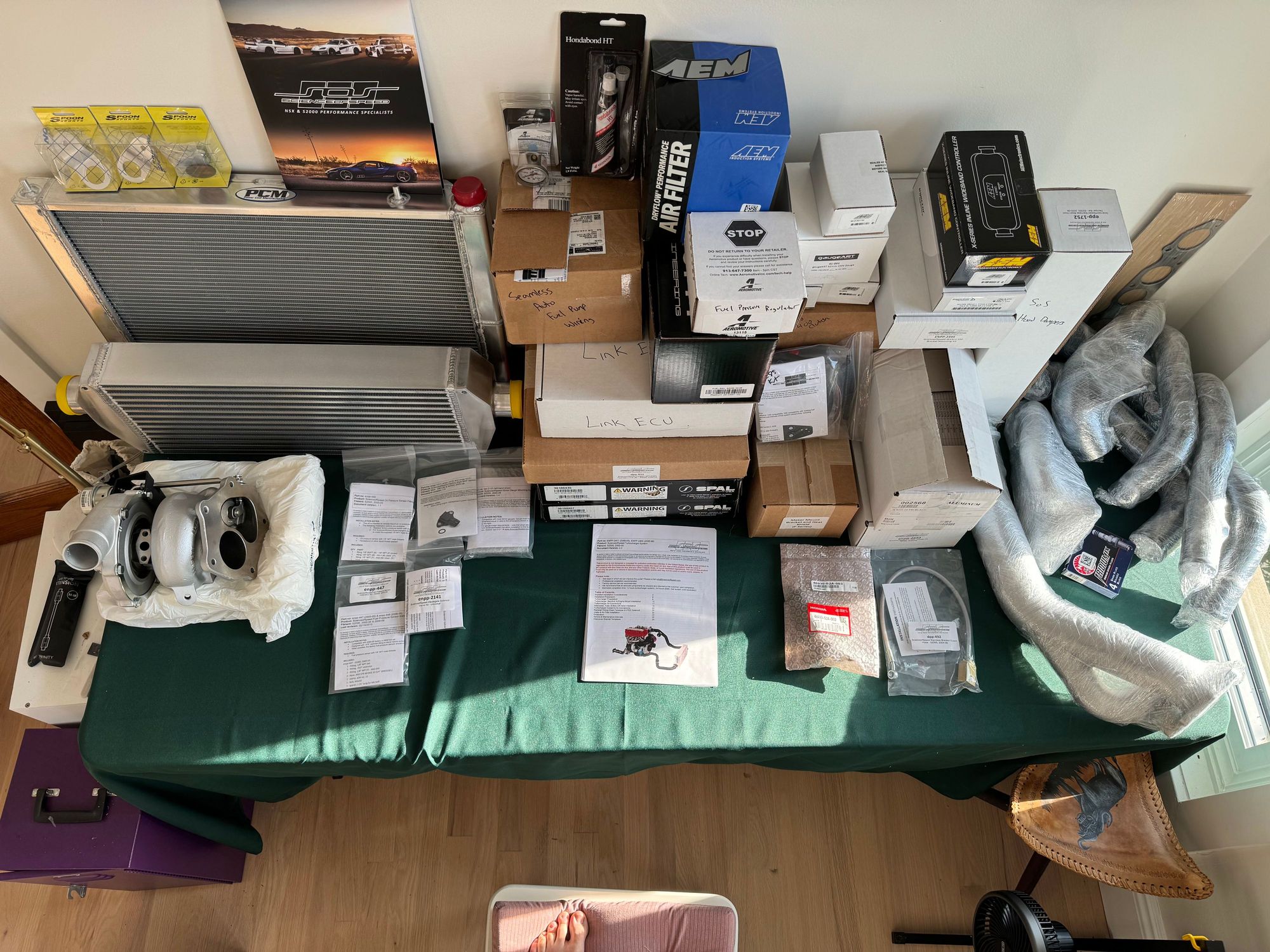

Hi all, I just pulled the trigger on a bunch of upgrades to my 2005 NFR S2000. The primary upgrade is a Science of Speed TS-MAX Twin-Scroll kit. I went back and forth between the PTuning kit and SoS but ultimately wound up choosing SoS.
Car is here: https://bringatrailer.com/listing/2005-honda-s2000-158/
I had initially decided on SoS until I realized PTuning had a higher power potential. Then I was camp PTuning for a while until I learned about the pitfalls of that kit, specifically the engine mount stiffness/vibration and boost creep/control issues. Those issues pushed me back to SoS as I want the car to feel as stock and reliable as possible, and I'm not really looking to push anywhere above 500-550WHP. My initial goals are 400WHP on pump gas but I'm speccing out the system to be able to push the limits on E85 once I beef up the rest of the drivetrain. I also liked the smidge faster spool of the SoS and greater area under the torque curve. All that said, with this decision I've accepted that the car will have less power potential and less top end than if I went with PTuning. I'm not expecting HP to increase all the way to redline, but I'm hoping the 3582 will get me as close as possible.
The car is pretty much a garage queen with only 35k miles and no expectation of tracking/dragging/racing. I'm just living out my teenage dream. The only mods so far are a dual TI 3" exhaust from Ballade, Berk HFC, Focal Speakers/Amp, Sony HU, and a mix of various accessories from Modifry.
Nate was a big help at SoS getting things specced out and written up. Their customer service thus far has been impeccable. From order date it took around 3-4 weeks to arrive. They had most everything in stock but it took a bit longer to get the pipes Cerakote coated.
If anyone has anything specific they want me to document or answer let me know! Also, if there's anything it looks like I'm missing that I should be considering I'm all ears.

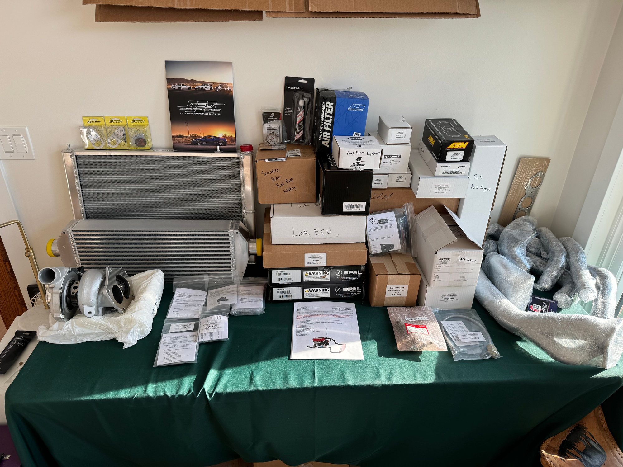

Turbo Kit
SoS TS-Max Twin Scroll Turbo Kit w/GT3582R
Cerakote Silver Ceramic Coating
Engine Management/Sensors
Link G4X ECM
AEM Wideband Air/Fuel Sensor
AEM Fuel Pressure + Relo Kit
AEM Oil Pressure + Relo Kit
AEM Air Inlet Temp
SoS 3Bar Map Sensor
SoS Wastegate Solenoid Valve
SoS E85 FlexFuel System
Fuel
Walbro 450LPH Pump and SoS Bracket
Seamless Auto Fuel Pump Wiring Kit
Injector Dynamics ID1300X Injectors
Radium Fuel Rail and Plumbing
Aeromotive Fuel Pressure Regulator
Aeromotive Fuel Pressure Gauge
Cooling
Mr Sideways Dual-Pass Radiator and Spal 10"/12" Fans
Spoon Radiator Cap and Stays
Drivetrain
SoS 400 Hybrid Clutch
SoS 11.5lb Forged Flywheel
SoS AP1 Clutch slave Cylinder
SoS Braided Clutch Cable
