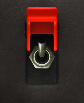

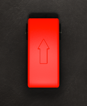

And ap1, to answer your question, I recommend a big red button in the middle of the dash with a flip cover like the pickle switch on a fighter plane.

Like this:

lol im all over it! ill have to run to advance auto parts real fast.
