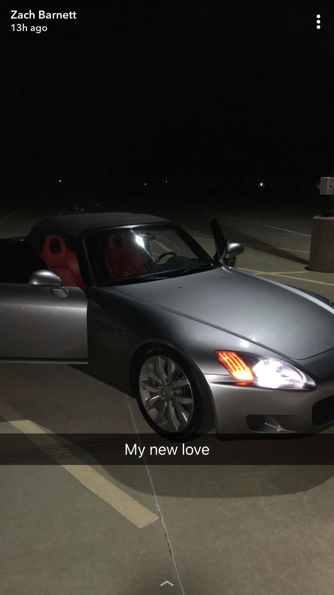

Hello all! As the title suggests I am going to turbo my lovely AP1. I will be explaining why I chose the products I chose, my goals, and I will most definitely have some questions and would greatly appreciate feed back and ideas.
So for starters I have a MY2000 AP1 with just over 100k miles. The car is stock except for a Tomei catback. The end goal is a reliable 450-500whp on e85 and 325-350 on the awful 91 available in Cali. I don’t want a laggy setup and I’m not shooting for crazy high power, I just want more power and turbo noises. I guess I’m also saying I don’t want a drastically different power band.
