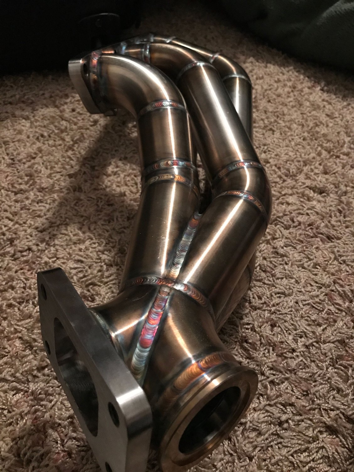

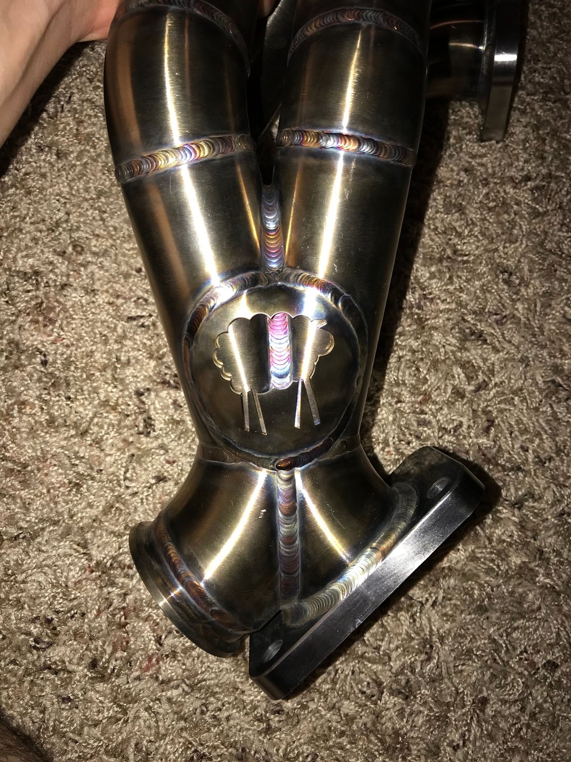

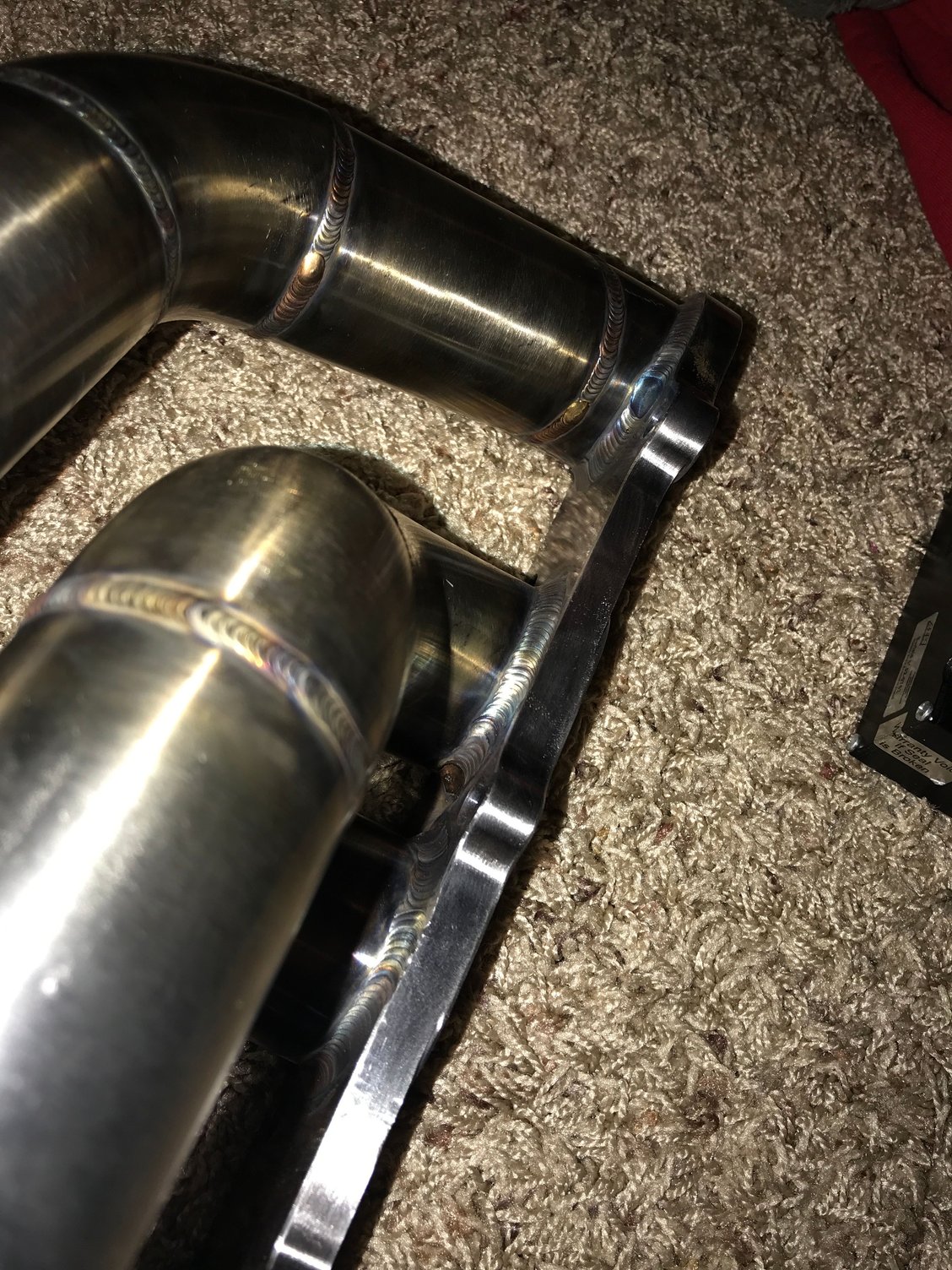

For starters I finally got to see my Sheepey manifold and it is gorgeous
The welds look good and it feels sturdy.

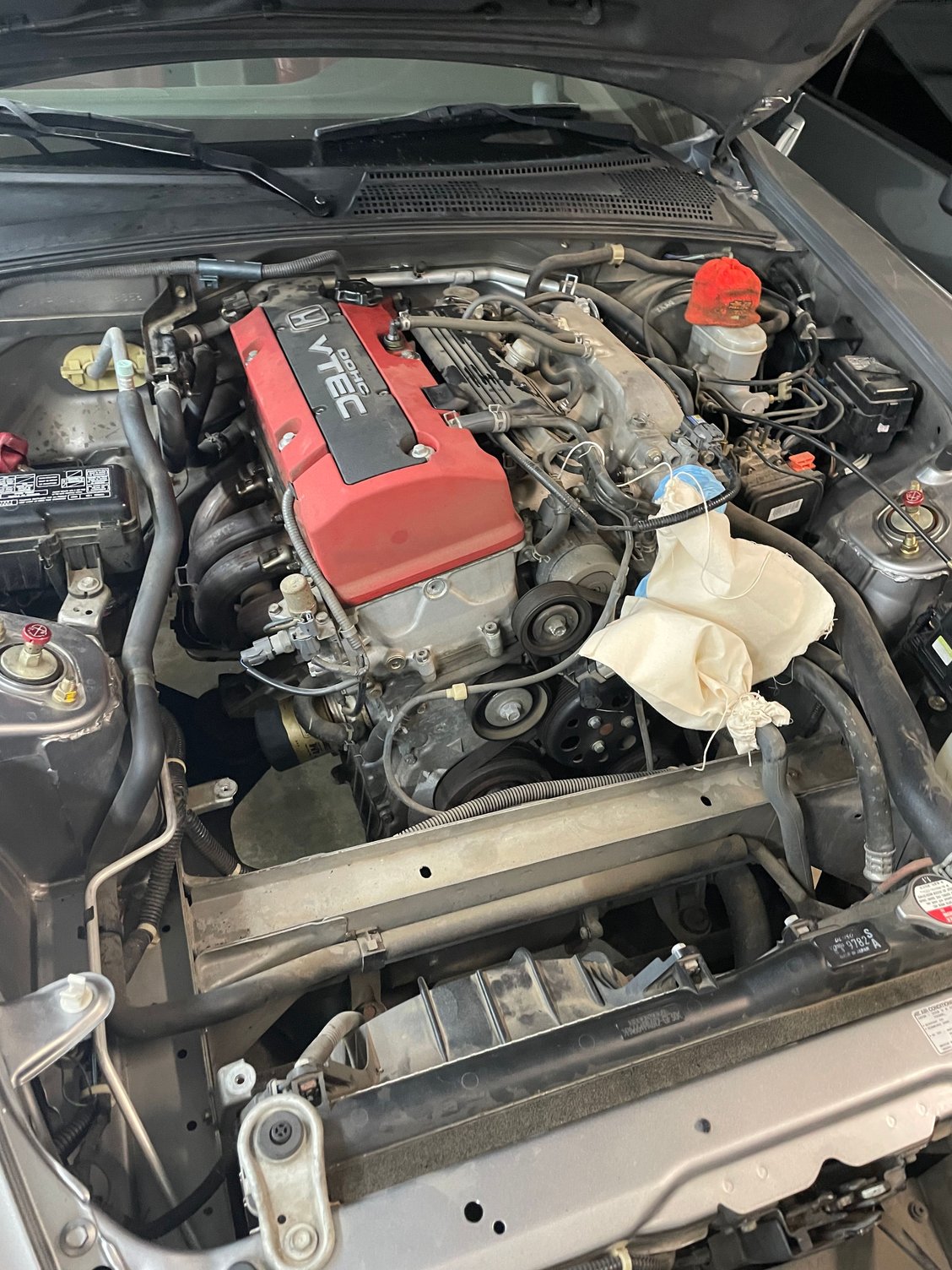

So it’s been a long while since I last posted, life happens and things got put on pause. I did however acquire more parts in my time away.
The following parts were acquired, I’m sure I’m forgetting some smaller things:

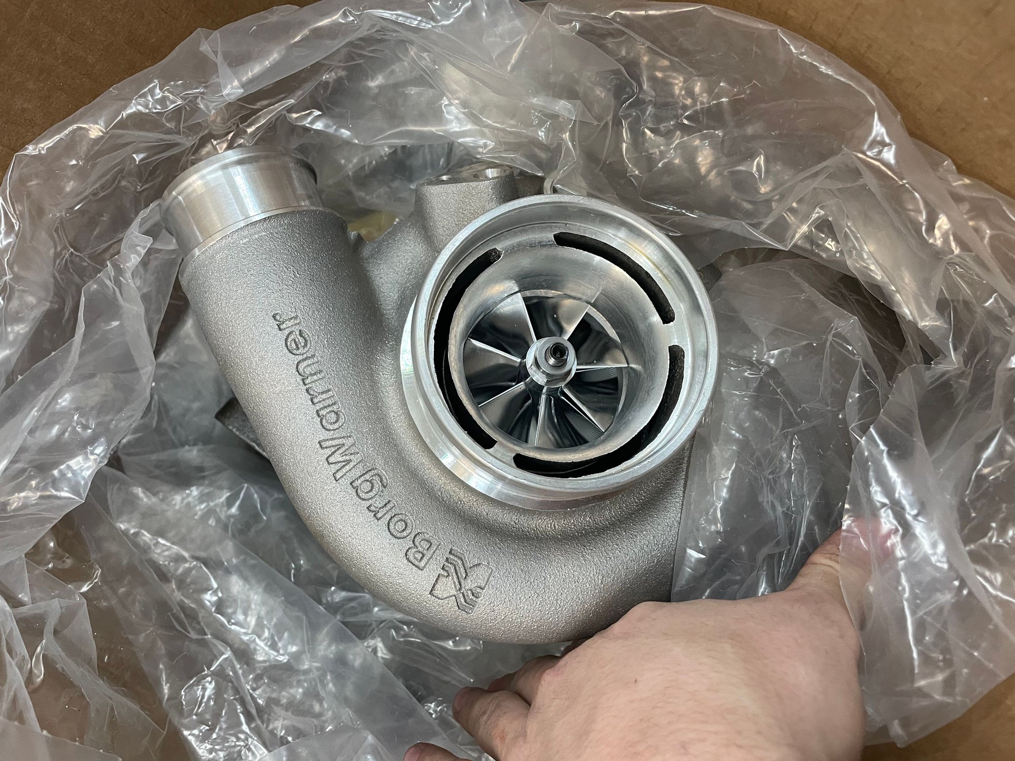

-BW s257sx-e 0.82ar
-ID1300
-Walbro 450
-CX racing intercooler kit
-SOS flex fuel kit
-AEM v2
-ARP exhaust studs
-AP2 keepers and retainers
-New valve stem seals
Things still needed:
-BOV
-Wastegate
-Clutch
-Gaugeart CAN gauge
-Wheels and tires
-Headstuds

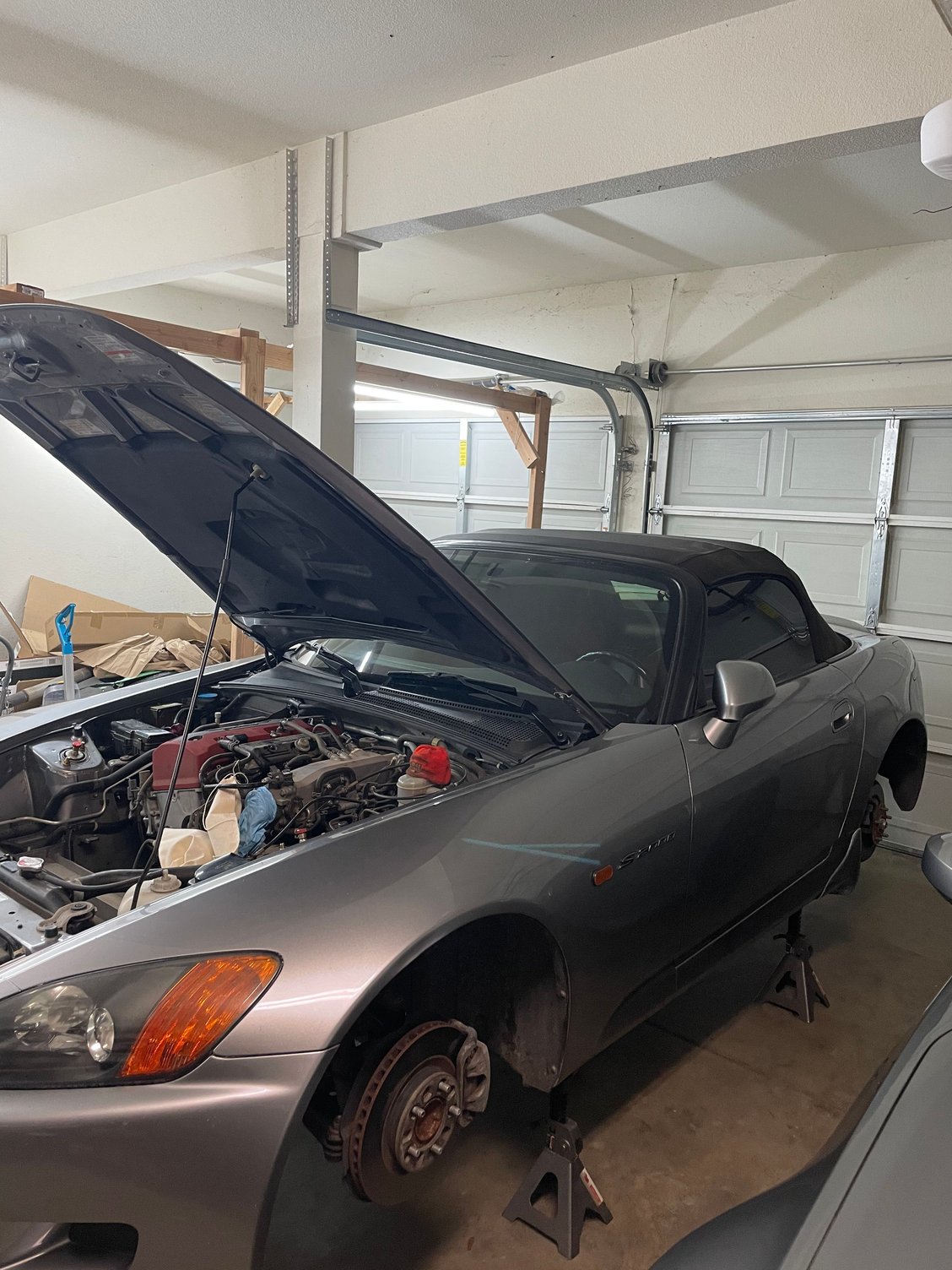

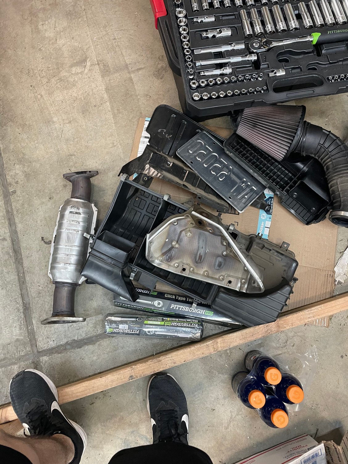

I started the build finally though, put the car on jack stands and removed the air box to clear up the front. Started removing the header but the o2 sensor before the cat is not coming out so I blasted it with some penetrating oil and will try again whenever my schedule allows it. Once the header is off I plan to install the new ARP exhaust studs.
After the exhaust studs I plan to move to the head and do the valve stem seals, AP2 keepers and retainers, and then the headstuds.
I am not the most experienced mechanic, I’m more comfortable with wiring than the mechanical parts, however with this forum, YouTube, and Facebook groups I’m pretty confident I can do most, if not all, that is needed to make the car a solid machine. The only thing I will not even attempt to do and leave it to someone with way more experience is tuning the car. I understand my lack of knowledge and experience could damage the car, but seeing as how I’m never selling the car I accept that risk.
I hope you all will join me on this journey and share your experience and knowledge with me.
