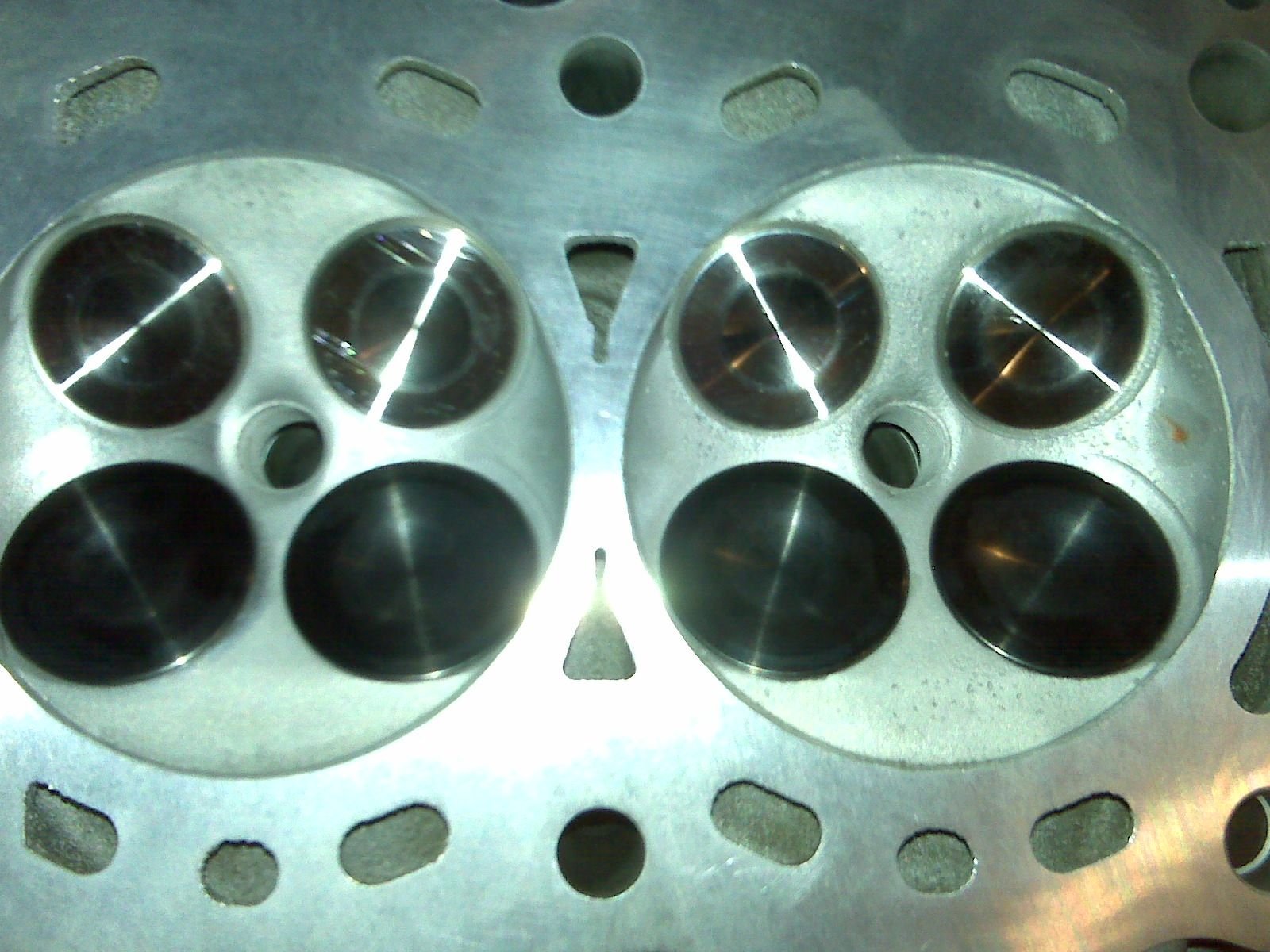

Man that thing is gonna be sweet. Good job on the way you did the rear.
Your cylinder bowls look really clean.
Take a look at mine after the head build. I'm not too sure if the pitting is from coolant getting burned, detonation or if its just the way the Honda bowls look from the casting. Did IP do any work to clean the bowls up or did they have any pits in them before you had it worked on? I was told from the head builder that the pitting wont hurt anything but who knows.
