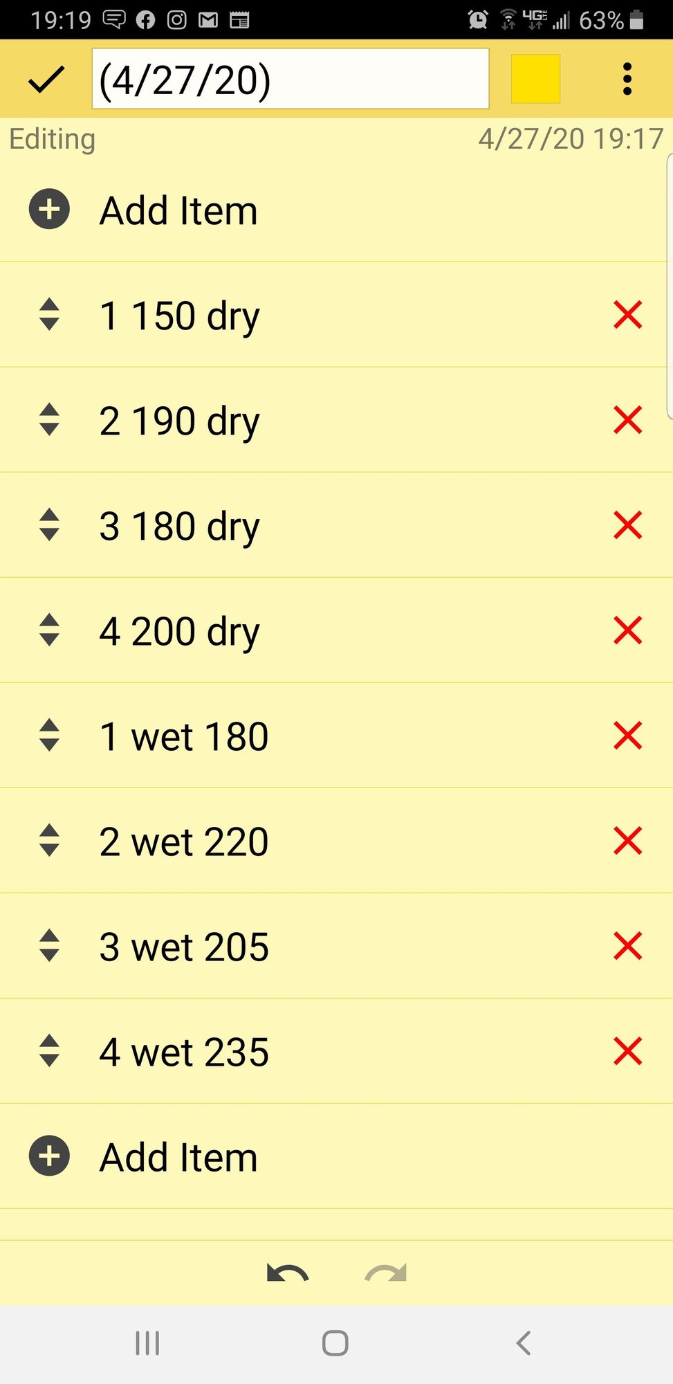

Where else would you vent them to? The catch can fills up every 500 miles or so, and I just dump it... return hose as in, back to the oil pan?

From your compression numbers, cylinder 1 doesn't seem too healthy.
All signs are saying the engine is bad. A leak down test should help determine where the leaking is: rings vs headgasket but given symptoms, I'd wager rings are going.

I had a similar problem, running 15 psi and after a few days started getting smoke out of my catch can , I ran a compression test and it wasn’t well, I have my motor out right now going to rebuild it , but we believe it’s bad piston rings etc block,
