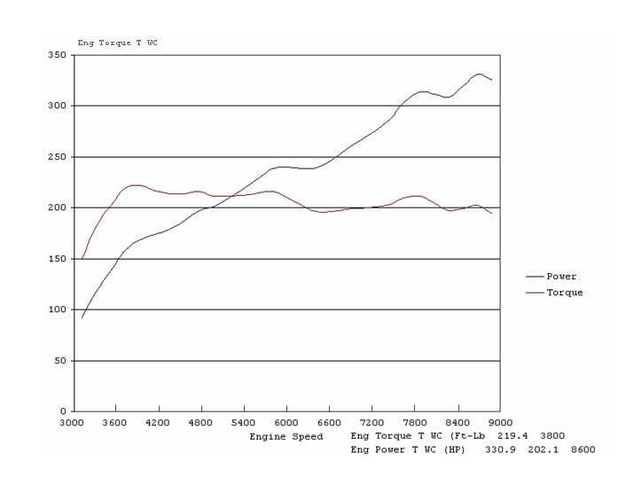

I'm at 330whp (Dynojet) with the Greddy, have been for 4 months now on a daily driver. The same setup did 299 on a Mustang dyno, which is correct. It DOES run faster than centrifugal SC at a given peak power, the power curve is completely different. I'd say my car feels closer to a Vortech with 4.56's.
Should be able to add 10-20whp once I adjust the upper rpm AFR - that IS 350whp, and that should be pretty much maxed out. I suppose I could go the HG route later, which would be cheap. It looks easy to install, but I'm coming from a background of growing up with master mechanic - I rebuilt my first tranny, a 2-speed (thats right, 2 speed) Turboglide before I could drive.
Actually I'm not interested in the peak whp number I post - I rarely drive the car above 8500rpms, nor do I drag race.
