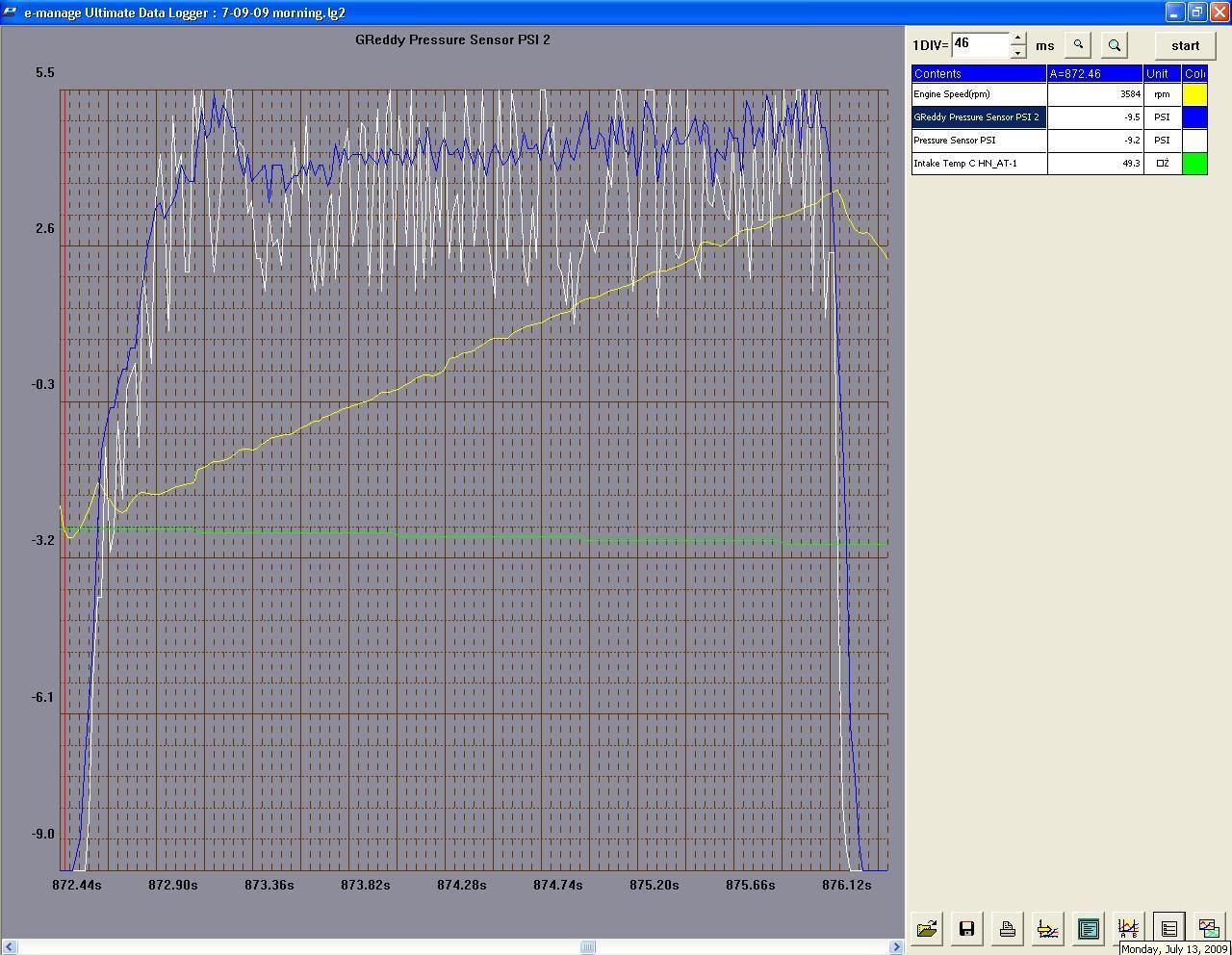

quick question, motors are essentially air pumps, would different displacements for our two motors mean that they pump different volumes of air relative to the rpm u are at?
would a 126 pulley on an ap1 be different then a 126mm pulley on an ap2 becuase of the volume of air each motor consumes per revolution?
gotcha, well the emu is prolly adjusting based on the oem map sensor. so if possible, log that, rpm, air temp, and knock.
emu is load based vtec at i think 4k. i know its sounds dumb, but floor it in like 3rd at 3400rpm and listen for the vtec transiion. theres a audible tone change when cam swap happens.
eitherway, lets try and see what/where in rev range these peaks are happeneing. a 9.2 peak but consistent 8would be ok. possibly, if vtec is kicking in at 6k still, your peak of 9,2 is right before there, as low cam is inefficient and that would explain the peak. need to see a log meng!
I would be ok with an occasional 9.2 spike, but the 11.2 was the highest yet and kind of out of my comfort range for long term.

Just a guess that there is going to be some variation in boost due to air temps, but look at the vast difference in rotational speed from the 126 pulley from an AP1 to an AP2. It seems pretty logical to me anyway that you could expect higher boost levels from the "stock" pulley on an AP1 versus an AP2. Even though the engines have differences in compression, displacement, cams and header, the speed of the blower is ~13% higher on the AP1 with the same pulley.
Could it be safe to assume that since WLaurent, Neptuner and I have all seen boost levels at 10psi and up from the 126mm pulley that maybe the assumption that it is a ~6-8 pound pulley might be a little low of an estimate on the AP1 and what we are seeing is normal? My high readings are in the realm of "spikes" when running it all the way to redline (which WLaurent posted he rarely does) So maybe there is nothing wrong with my car or Neptuners and that this is what one could expect from a 126mm pulley.?.?.?
Its been shown to produce at least 10psi on three AP1's.
I like the power with this kit and that is even without a custom tune yet, but I almost think a smaller pulley in maybe the 118-120mm size might be good for the "stock" one for the AP1 kit. Or at least the option to get one would be good. Don't know how to source something like that if anybody is in the know feel free to let me in on the secret. If this is what psi to expect out of the 126mm then maybe I got a "stage 2" boost upgrade for free. I don't see it as a serious problem but having a smaller pulley for when the weather gets cooler here would be a decent idea. The coldest the car sees is 40 degrees but that could push the boost even beyond 11.2psi. I really don't ever want to push ~14-15psi into the car.
