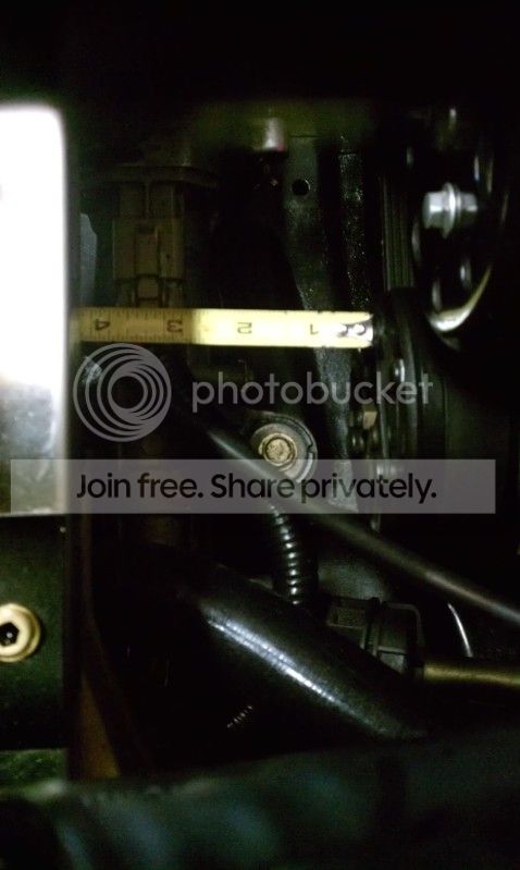

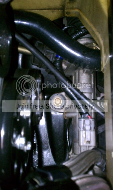

Is this what you are looking for?
If you need any other shots let me know.

Trying to see if there is space in front of it have the dump tube exit there. Thanks for the picture. Does it look like there space for a dump tube to exit in front of it?
Are you trying to dump them under the car? I don't know man, it's kinda tight with the steering rack, lower rad hose, front subframe

Just went out and took some more measurements. It's pretty tight, you have about 3" of clearance between the serpentine belt and subframe (half way between the crank pulley and ac compressor pulley). The clearance tapers down the closer you get to the ac compressor (less than 2" directly below it).
It might be do-able. I think maybe coming in front of the motor (parallel with the front cross member), doing a 45 degree elbow below the serpentine belt (half way between crank pulley and ac pulley).
What's the outer diameter of the dump tube?
