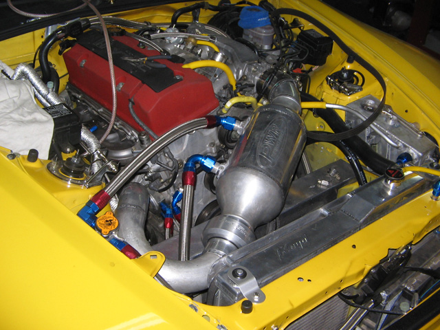

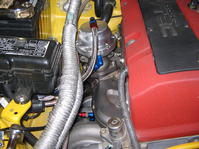

Originally Posted by t.vo408,Jul 5 2007, 07:20 AM
Yeah, I wish there were some other pics of it.
Here a few older pics of it installed. I've since upgraded to a 44mm wastegate and had it ceramic coated.
Old Jul 11, 2007 | 05:36 AM
  #36
MugenRioS2k's Avatar
Joined: Aug 2006
Posts: 3,214
Likes: 32
From: Huntsville, AL
Love the PWR intercooler.
Can you pm me some pictures of the inner core if you have them. I have heard that this is a tube in shell configuration.

[QUOTE=MugenRioS2k,Jul 11 2007, 05:36 AM] Love the PWR intercooler.
Don
Old Jul 26, 2007 | 11:56 AM
  #39
Joined: Aug 2006
Posts: 3,214
Likes: 32
bar and plate design
was hoping for a tube in shell configuration
Old Jul 27, 2007 | 06:09 PM
  #40
trivium's Avatar
Banned
Joined: Oct 2005
Posts: 2,723
I like the setup with the PWR unit. I am looking into the exact same thing. It requires no ambient air and I wonder if in the end it will prove worthwhile. I also wonder if it really does improve turbo spool since less piping is required?
