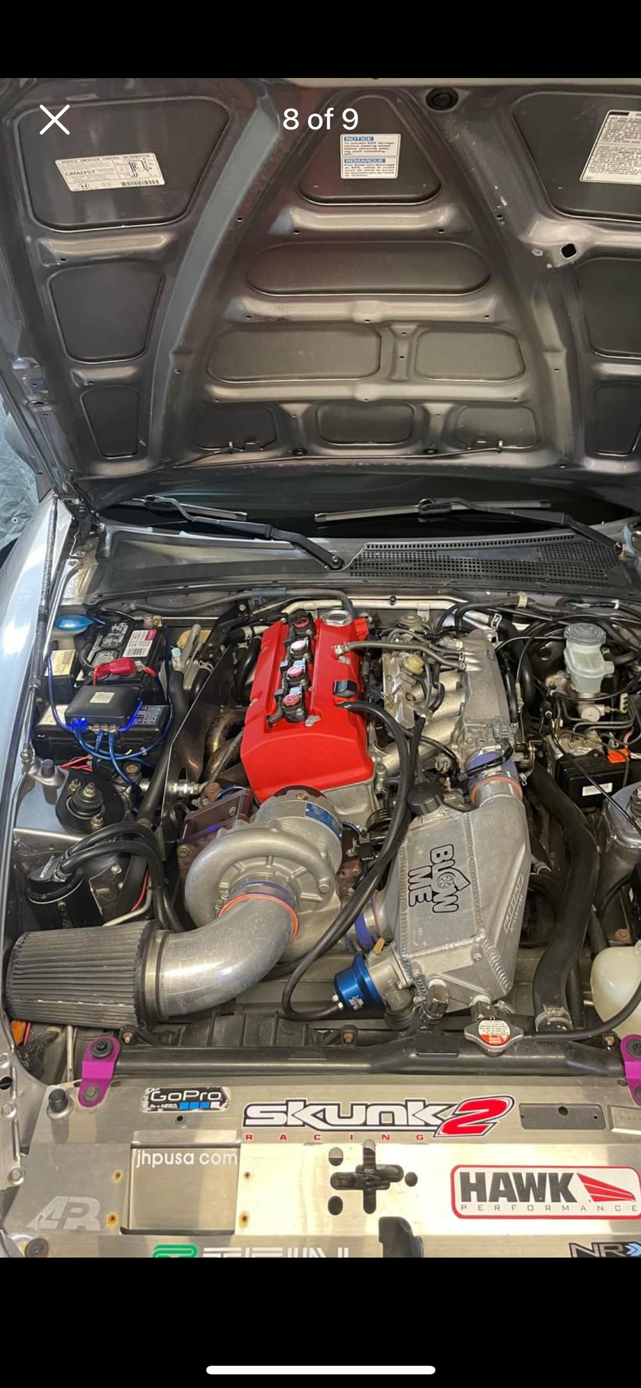

I was wanting to know if anybody knew what this kit is? Purchased car a few months back, supercharger already installed, 1000cc injectors, vortech v3 sc, vortech bov, vortech cooler, aemv2 ecu. Im wanting to go from 6psi to either 8-10psi, and need the belt accessories etc.
I also live in Minnesota, not too many local tuners around, any etune recommendations?

Vortech. If you zoom in on the pic it says it right on the side of the aftercooler lol.

Yes everything is vortech, but vortech doesn't make an S2000 kit, or it got discontinued, are all of their pulley and belt sizes universal or do I need to find the kit supplier?

Vortech used to make kits for our cars.
Parts no longer available. But shouldn't need much to keep it going.
Vortech itself is easy to rebuild. Pulleys, just replace the bearings as needed. Belts are sold by length.

Vortech as mentioned (and you mentioned in your first post, haha). I've got the same kit but with traditional oil feed and return (V2). Check superchargers online for parts you need including pulleys. You might want to inspect the VTEC solenoid sandwich plate as the stock ones Vortech supplied are known to crack and leak oil.
