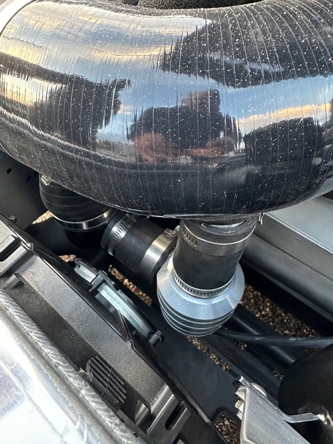

Default Problem solved!
Hey guys. I have an update. I got the Turbosmart 34mm bypass valve, but it didn't fit with the existing plumbing. So I took the group's advice and bought the Forge Supersize. That thing is a beast and makes the plastic one I had look like something you get from a gumball machine. Anyhow, I had the new Forge installed and the flutter is completely gone. Instead I have the wooshing sound of air, which is better for sure, but still pretty loud. I guess everyone's is that loud? I used the db meter app on my phone and the average noise is 95db when cruising on the highway, which is pretty loud. But I do have a vented carbon fiber hood, so I guess that comes with the territory. Anyhow, flutter problem solved and I appreciate all the help. Pic below of the new valve installed.
