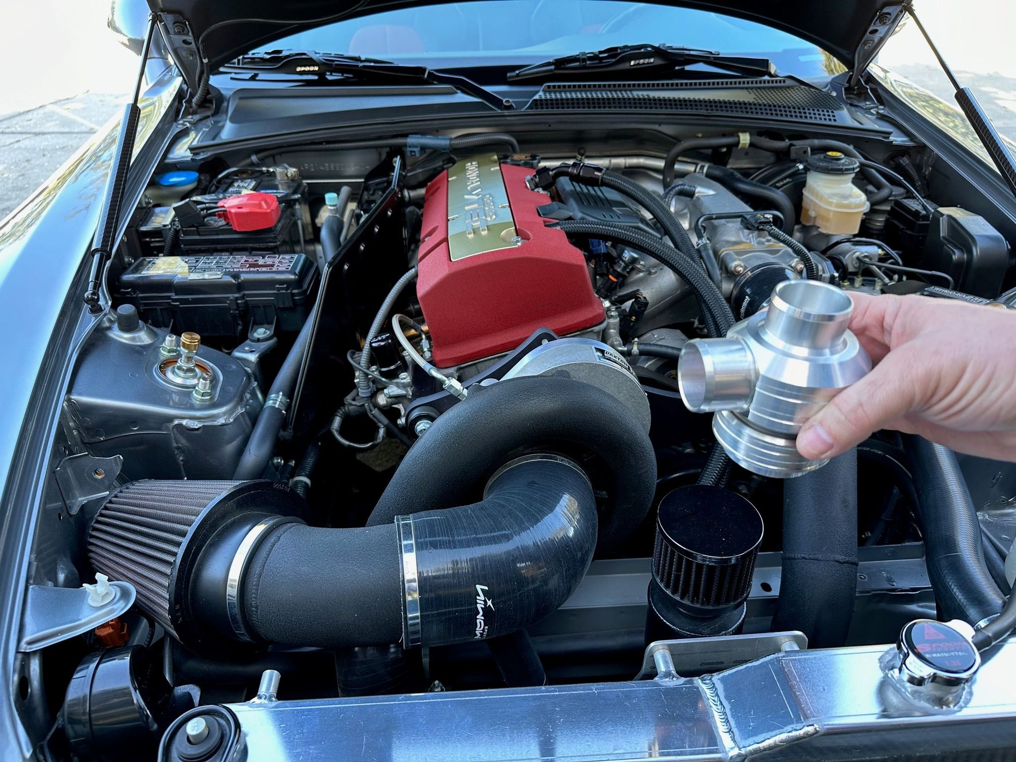

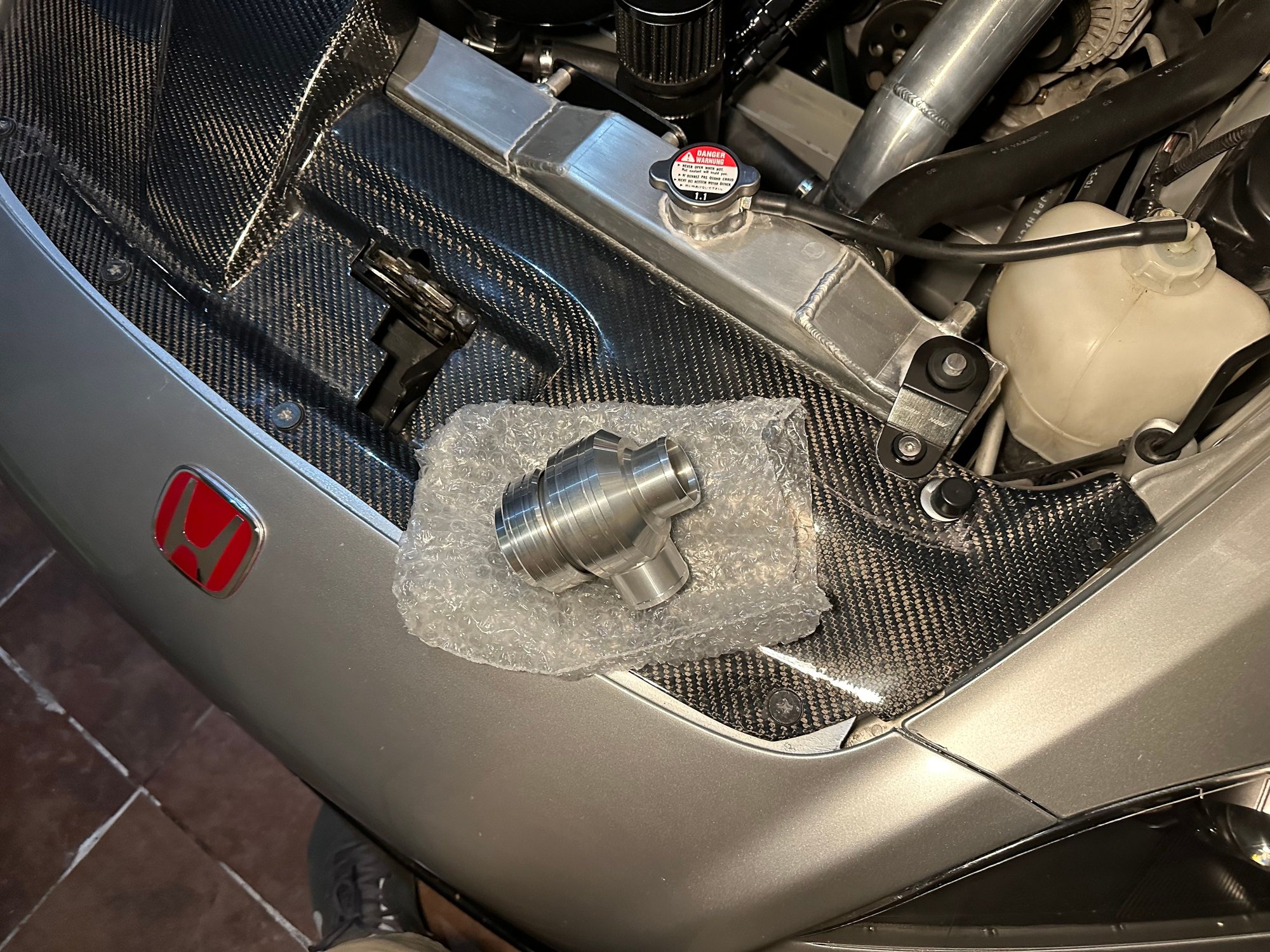

Hey guys. I have an update. I got the Turbosmart 34mm bypass valve, but it didn't fit with the existing plumbing. So I took the group's advice and bought the Forge Supersize. That thing is a beast and makes the plastic one I had look like something you get from a gumball machine. Anyhow, I had the new Forge installed and the flutter is completely gone. Instead I have the wooshing sound of air, which is better for sure, but still pretty loud. I guess everyone's is that loud? I used the db meter app on my phone and the average noise is 95db when cruising on the highway, which is pretty loud. But I do have a vented carbon fiber hood, so I guess that comes with the territory. Anyhow, flutter problem solved and I appreciate all the help. Pic below of the new valve installed.
Did you just install the larger tube over the recirculating port on the silicone intake or install something inside the silicone so it doesn’t collapse?
I just picked up a used S2000 last week that has a similar setup and flutters like crazy as well. My charge side is coming from after the intercooler though.

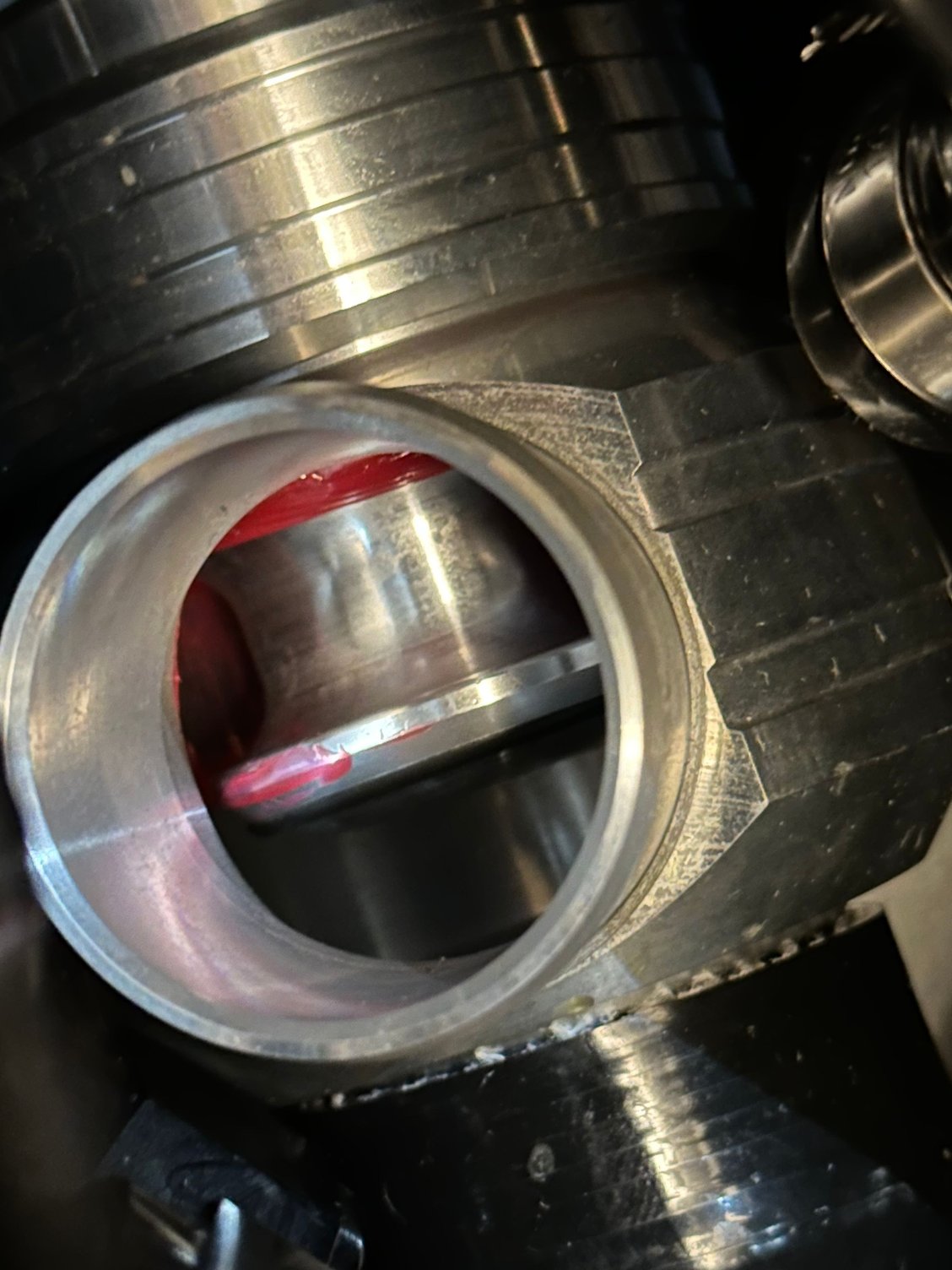

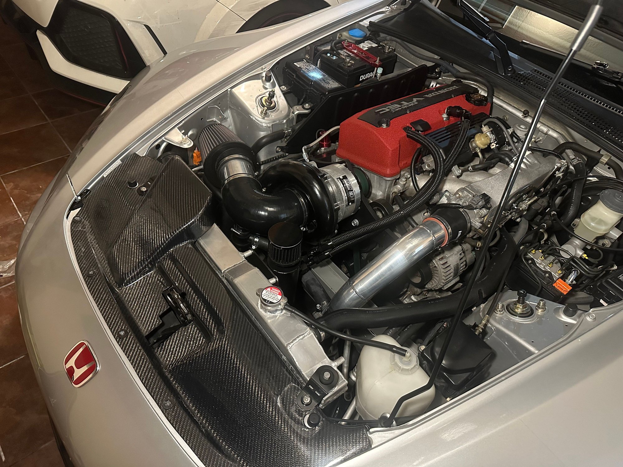

Did you leave the spring that it came with in or change it out for another one? I am hoping to get mine mostly plumbed up tomorrow. I was worried about the existing 1” ports sine the supersize is 1.5” so I just ran a test where I disconnected the hose on the charge side and let it vent to atmosphere. After letting it warm up I gave it some revs and no flutter . While I was testing that I also hooked up the vacuum line to the Forge and it looked like it was working but not sure if it is opening all the way.
I ordered the spring kit when I bought it so I could always try a lighter spring.
My other question is on which way it should be installed. As mentioned earlier in this thread someone pointed out that the original Bosch one installed was backwards (charged air coming in at the side of the valve). I didn’t find any documentation on how it is supposed to be installed. Obviously if the charged air is facing the valve it will help push it down and open it up. Any feedback would be appreciated.
As a side note it sounds like one of the bearings in the supercharger needs to be replaced. Any suggestions on where to send it for a rebuild besides Paxton?
Thanks for the help, the urge to drive the car is killing me!

I did not use the spring it came with. I spoke with a couple people about it, including John at LHT, and everyone said to use a soft spring. John said to use the softest one I could get. I spoke with the folks at Forge and they said I should use their blue spring. So I bought that with the valve and swapped it out before install. It's been working fine. Not too soft from what I can tell, and the guy who did the install for me said it was good too. As for which way to install it, you are in luck. Forge's US location is located right here in Orlando where I live, so I went to pick up the valve in person with them. The guy there was great and incredibly knowledgeable, as you might expect. I had him hold the valve in the correct install orientation for me and took a picture of it which is below (assuming your set up is the same as mine, which you can see in the other pics in this thread). Good luck with the install. Let me know how loud you think yours in when it releases the air when you are off throttle or cruising. As to your last question, I've got nothing for you on where to get the SC rebuilt. Maybe someone else knows that.
