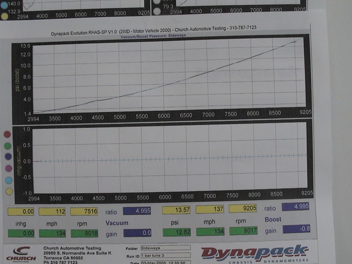

Has anyone done this before? And please show me how wrong I am on a dyno..all the dynos I have stored in my PC from this forum show the same result..0-4000rpm no gain at all, and than from 7-9000rpm a huge jump in power.Have a look at the Ultimate Racing dyno that compares the kit with the 2 superchargers...
Dyno #3 (+13 lbs boost)
Dyno #1 (baseline) & #2(+7lbs boost)
At 4000 rpm the baseline was 95hp. It was 110 hp with the Vortech in stock form and 125 with the boost upped.
At 4000 rpm the upped boost put the output where the factory engine is at 5200 rpm.
The torque curve does rise dramatically with the engagement of V-tec.
(#3)
So I guess the answer to you question, the Centrifical Superchargers do not add extensive power below 4000 rpm but is certainly inappropriate to say "no gain at all."
Let me qualify this, centrifical superchargers can add up to 30 hp and 34 ftlbs as demonstrated or potentially more (
) when pushed. They also can add about 15 hp and 17 ftlbs with the manufacturers stock boost at 4000 rpm. IMHO, The difference this makes in driving is very usable.
(#3)
With the centrifical supercharger we are seeing boost from about 2000 rpm on under full throttle.
This shows boost of 1.4 lbs at about 3000 rpm.
Others' numbers will vary since every engine is different and mine has been modified with head work and CR change. The V-tec engagement point was modified.
Now, to answer the original question. Go with the smaller pulley and lower the redline to stay out of trouble.
That does the same as "increasing the area under the curve" while shortening the curve slightly. See the above examples.The SC will over spin if you go too small with the pulley or to high with the rpms and thus it is not possible to see turbo type boost this way without dropping the redline to less than half. That can't be fun.
Let us know what you end up doing.

"At 4000 rpm the baseline was 95hp. It was 110 hp with the Vortech in stock form and 125 with the boost upped.
At 4000 rpm the upped boost put the output where the factory engine is at 5200 rpm. "
- you know that a 15hp increase at 4000rpm is not what u are looking for after spending 4500USD (actuall best price for the Vortech talking about the stock unit, if u know better pls. PM me)
2)"The torque curve does rise dramatically with the engagement of V-tec."
-thats what I am talking about in my first post, it makes the f20c stronger there where it is strong already, not there where I want to improove it.And NO, I will not trade it for a Stang:O)
3)"So I guess the answer to you question, the Centrifical Superchargers do not add extensive power below 4000 rpm but is certainly inappropriate to say "no gain at all."
-with a stock unit it makes less than 10hp in that area, that is not NO GAIN AT ALL, you're right, but also not what you would have expected after going true all this.
4)"Let me qualify this, centrifical superchargers can add up to 30 hp and 34 ftlbs as demonstrated or potentially more (
) when pushed."
-I want to buy>install>tune>drive and have fun...I don't wanna puch anything or anyone (besides sitting on the toalet on a bad day
5)"With the centrifical supercharger we are seeing boost from about 2000 rpm on under full throttle.
This shows boost of 1.4 lbs at about 3000 rpm. "
-any turbo kit makes 80% of max boost at 3500rpm..
