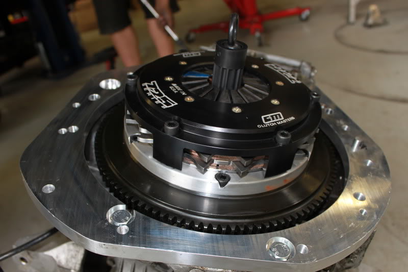

That looks exactly what we've done . Our problem is we've got a Carbonetics clutch which needs a new spline, or whatever you call it.

Originally Posted by wadzii
this is what I have been waiting on before building a turbo s.. My only reservation is the CM aluminum flywheel. I think everyone in the industry has had their issues with those, a Steel flywheel option would be great.
This is a steel flywheel with an aluminum adapter for spacing.
could you provide us with one for the Carbonetics? That would be great. Are you also offering Supra diff placement brackets and such?
I have a carbonetics clutch as well and unfortunately you would have to modify the hub to make it work. Also, you will have to figure out how to space the whole unit out.

Originally Posted by FullBlown
Originally Posted by Spoolin' timestamp='1314930290' post='20936871
Btw LJ, will I still be able to use my CC twin disc clutch with this setup? I sure hope so since I just got it in last year. It barely has 500 miles on it. LOL
Chad, Im 99% sure that you can. Fernando from Kings Performance will be running that clutch. You will have to get new discs but those are pretty cheap to replace.

Its a tight fit but this is going to work for sure. We still have to make a few adjustments to the clutch assembly but no biggie, we knew its going to take some R&D to get this right. Next up is the tranny mount and the shifter bracket.
